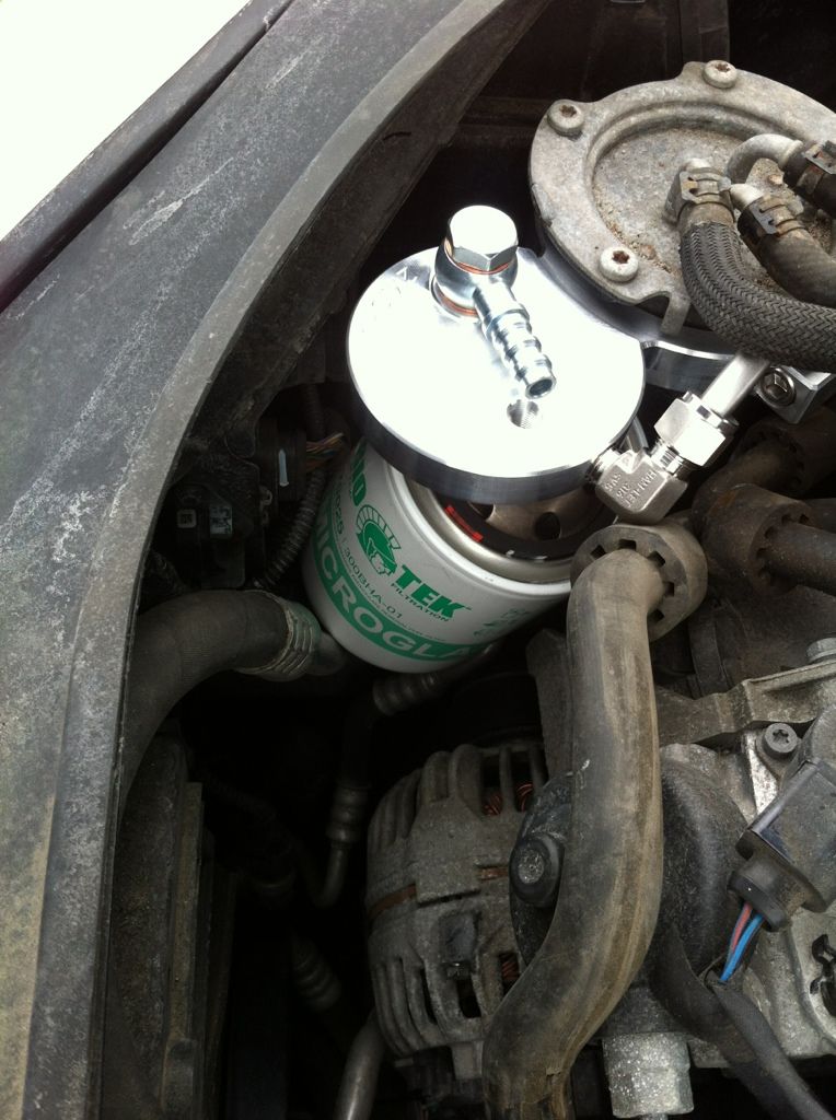

so it looks like to change the normal factory filter you would have to disconnect the hard line over to the filter mount with the gauge on it?
looks like a nice kit Andrew. I might have to get one of these to put on the shelf so I have one to offer to my occasional CR customers.
I know I would own one of these if I had a CR TDI myself.

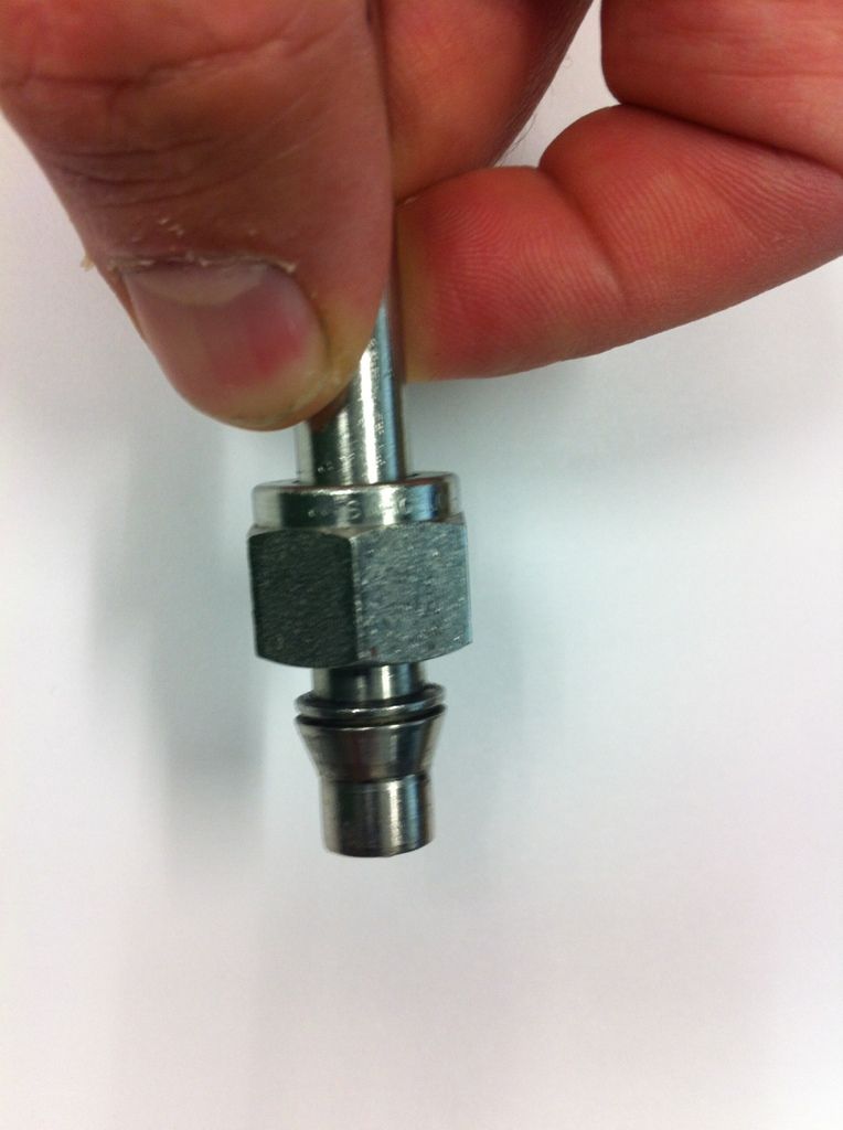

Hey Growler, Yes, you will have to disconnect the hard line to replace the factory filter.
It uses a really handy industrial Stainless Swagelok type fitting. These fittings can be used many times, over and over when retightened properly.
Here is a close up of the fitting:
Great observation, keep the questions coming!!!
All the best!!
Andrew

thanks for the reply. are they metric hexes? or am I going to have to start keeping some of those english wrenches in my box.. might have to keep them segregated so they dont intermix and start having whitworths or something... lol

.. are they metric hexes? or am I going to have to start keeping some of those english wrenches in my box.. might have to keep them segregated so they dont intermix and start having whitworths or something... lol
The Swagelok fittings are 11/16" (unfortunately about 17.5mm). The stainless bolts that hold the banjo fittings are 3/4" (19mm will work). The hex wrench to mount the contain flow bracket is 5/16" (an 8mm will work). A few inch tools are required. Most of these fittings are "standard" American fittings and therefore not metric.
I would want to etch the 2microntech.com logo on the Pureflow adapter on the HPFP as well, not just the manifold/bracket part.
There is a mixture of standard, metric and 2 Torx bits required to perform the install. All very common tools. I've been working with a few of our members to help with the install and have recieved great suggestions to refine the installation instructions. I'll certainly share the instructions with everyone, as soon as someone in LasVegas does the install!!!

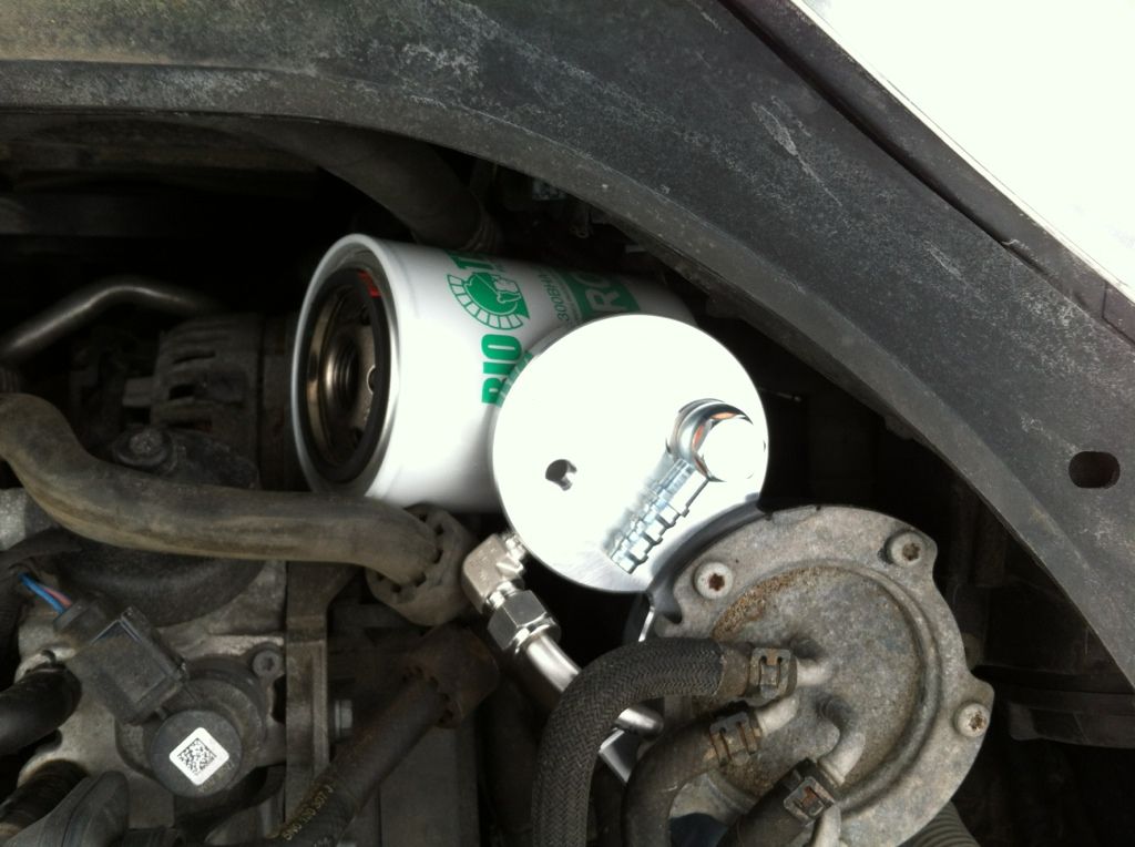

Wow!! Hello Australia, thanks for chiming in!!! One of the reasons for the placement of the Stainless 90 degree fitting is simply to access the spin on filter. If it were to be rotated, the filter would be impossible to remove. Ideally, the top would be best, but the hood gas strut (MK5 and Golf platforms) lays right beside the Guage, centered on the new mount.
Here's the filter being removed, installed:
Please share a couple pictures of your CEGA engines' HPFP and the filter canister. A couple of close ups and part numbers if possible.
Which fuel filter does your car use? Very interesting, we would all enjoy seeing pictures of another version of the engine family!!!
The filter is to be changed when the Guage indicator is approaching the 25 psi differential pressure reading. This is expected to last at least 2 times the North American 20k mile interval. This filter is performing a very easy task, removing the remainder of the particles left over from the 3-5 micron nominally rated factory filter. This is another benefit to adding the filter, as it acts as secondary filtration for your fuel.
1or 2 Micron rating level is a personal choice. The 1 micron filter will flow up to 25 gpm (US gallons per minute!!) Way beyond our requirements!!The price of the filters may also be a choice, $25 for the 1 micron, $12 for the 2 micron.
Personally, I prefer the 1 Micron filter and have had no issues during testing. These are very common filters from the Petroleum industry. These are used in refineries and on Fuel dispensing pumps on the street. The 1 micron filter (70025) is used on applications with High Bio content, as pitched by the Manufactur, CimTek.
Thanks for looking, the suggestions and all the best to Australia!!
