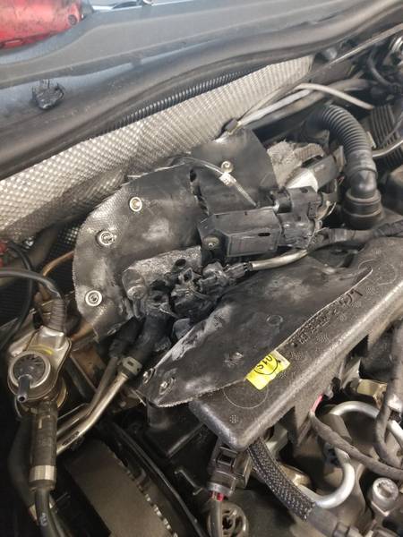

Not sure what these are, But these are what made my check engine light come on Friday after they fixed my car. I took the car immediately back after leaving when my check engine light came on and they checked them. . Nothing was wrong with them and they were completely fine, so they told me to just drive the car because it is just something to do with the emissions and it’s not a safety issue. Apparently it was a safety issue.

Not sure what these are, But these are what made my check engine light come on Friday after they fixed my car. I took the car immediately back after leaving when my check engine light came on and they checked them. . Nothing was wrong with them and they were completely fine, so they told me to just drive the car because it is just something to do with the emissions and itís not a safety issue. Apparently it was a safety issue.
DPF sensors 04L-131-552-DL
Happened to me as well, if you would have kept on driving it would of caught on fire.

I opened the hood of my 2015 Passat TDI SEL Premium last evening, after seeing this picture. I have the insulation wrapped item too, but it wasn't clear then to me what it was. Thanks for stating what that is. Obviously that insulation wrap is there for a purpose. I suspect the item gets quite hot, so the insulation wrap protects what is outside of the wrap? If so, this part must have gotten hotter than it should have for some reason. Any idea why it might have gotten so hot as to burn the sensor up?
