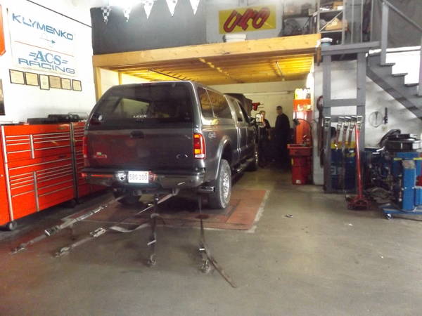

Let's see one of my ALH street setup with a computer control system did for added HP and Torque red is with CNG first time on the dyno
This on the Ford truck 70% CNG 30% on one test
the cost of CNG at the time was $1.00 a GAL below is a3 pulls with 2 CNG/D one for max power and one forever day driving
I do not do any more system cost of CNG is too high got a bunch of systems and support stuff I will sell off
