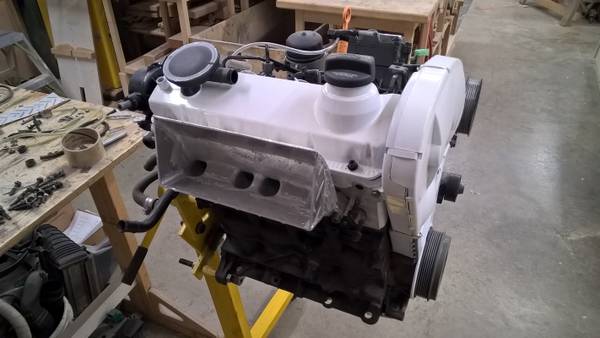

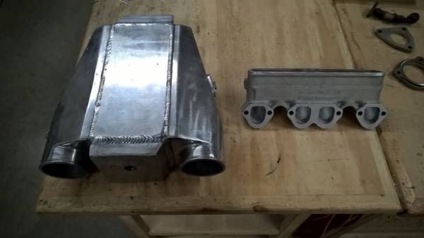

Alright intercooler time. If any of you guys have ever seen the space between the grille and the AC condensor on a Hardbody you'll know that there is no room for a traditional air/air intercooler in there. So my other option was air/water and I am really happy I went this route. As you will see charge piping becomes extremely minimal.
First pic, air/water cooler and chopped alh intake manifold.

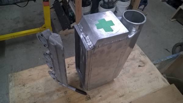

Mock up time

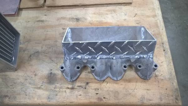

This was my first time TIG welding aluminum and I could not have picked a harder project. Welding crappy cast aluminum to scrap checker plate was a little difficult.

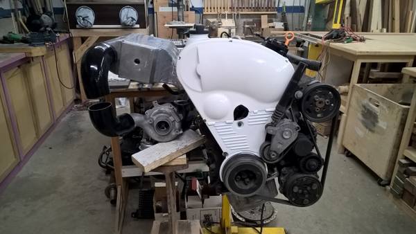

Test fit on engine time.
Duct tape the two together and put the turbo under it to see whats what.

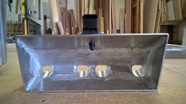

Add a mounting point for the 4 bar map sensor.
Then turn the two pieces into one and hey, you have a custom air/water intercooler. Welding the checker plate to the air/water core was a lot easier than the cast part.

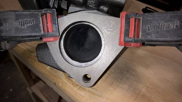

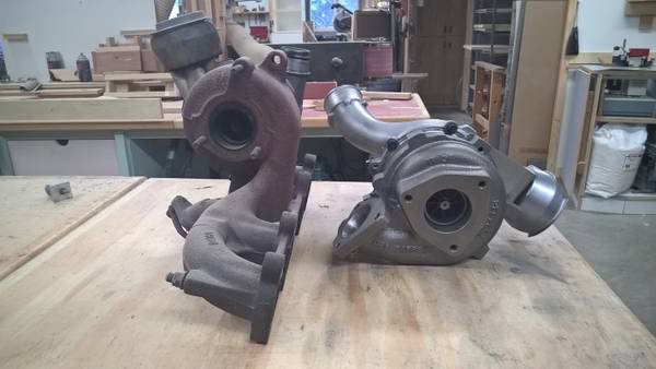

The eagle eyed among you probably already guessed what turbo I am using from the previous post. It is a GTB1756vk with vacuum conversion. From everything I could learn about the turbo options for these engines and my power goals, this turbo was the best choice.
Sitting beside the microscopic oem trubo.
I clamped the turbo flange to the turbine housing and there seemed to be a rather large step issue going on.
That was not going to be good for flow and EGTs. So out came the carbide burr and after a decent amount of time the step was no more.
