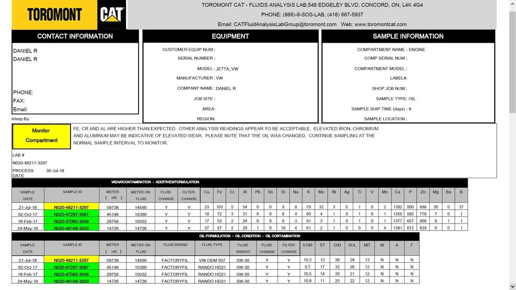

Originally Posted by Dannyboy View Post
Oh dear, doesn't look good. Emissions recall isnt agreeing with it. Emission recall done at 51k kms
3rd oil sample dealers gave me wrong oil. 2009+ oil apperently is a bit different
The 2009+ oil is 507 spec so it should have been the same. Now, the 2006 oil was 505 spec and definitely different. Next UOA should be interesting, wondering what's going on there.
Sent from my Pixel XL using Tapatalk
So do u think maybe u got someoneís else oil ?
Oh dear, doesn't look good. Emissions recall isn't agreeing with it. Emission recall done at 51k kms
3rd oil sample dealers gave me wrong oil. 2009+ oil apparently is a bit different
Why would the molybdenum values change so dramatically? That would concern me more than the sodium, I would think.
Molybdenum is an anti-friction additive. Some motor oils have a lot of it, some have a little, and some have none. Also, for those who want more, there is this>>>
Good eye. I forgot that I had a quart of ESP Mobil 1 507 and dumped it in , so it skewed the reading a bit from dealer oil.
I bought dealer oil from the first oil change, now I've decided to go a different route but staying to the VW507 spec to see if it helps.
