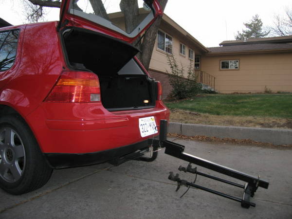

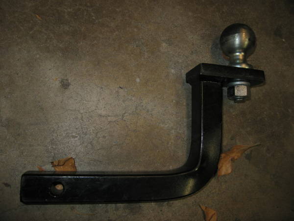

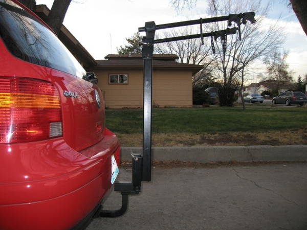

1 1/4" with 4 bikes are hard to come by. Or you can try what I did:
Take one of these but without the ball:
and weld it to this:
which now looks like this:
or this:
I forget which Thule model it was. Yakima-Thule...what ever. It was a 4 bike but I turned it into a 3 b/c I carry mountain bikes all the time. It will take 4. I bought a 2" model but cut it off in prep for the 1 1/4" transformation.
The draw bar is the tallest rise I could get at the time. This rack has been in use for over 3 years. It gets me to and from mtb areas as far as 8 hrs away one way with 3 bikes on, in the wind, at 80mph. No sweat.
Easy access to the back of my Golf and Passat sedan. Love it.
