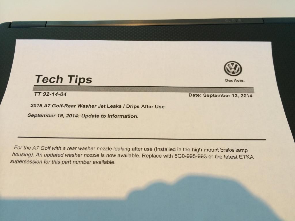

Leaking rear window wash nozzle after use. It dribbles.
Front drivers side wiper doesn't make full contact on the down stroke.
Haven't taken these into the dealer yet.

Leaking rear window nozzle. Dealer inspected and is ordering new nozzle per bulletin.
Going along with the nozzle, mine was the first 15 TDI the service dept has seen and as such all of the techs came over to ogle it and prod under the hood.

Anyone have the bulletin number?
Found it.
Tech tip TT-92-14-04
Chris
Found it.
Gonna be bringing mine in for this... ('-_-); could be worse!
