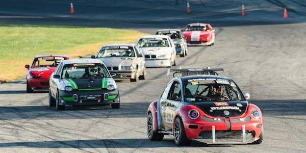

I have run the only TDI powered Beetle in the USA in Lemon and Champ racing for 5 years. done right they are supper fast after the suspension is set right .
As you cas see we are leading aver fast group real race cars.
this is our new car from last year soon to be TDI powered
