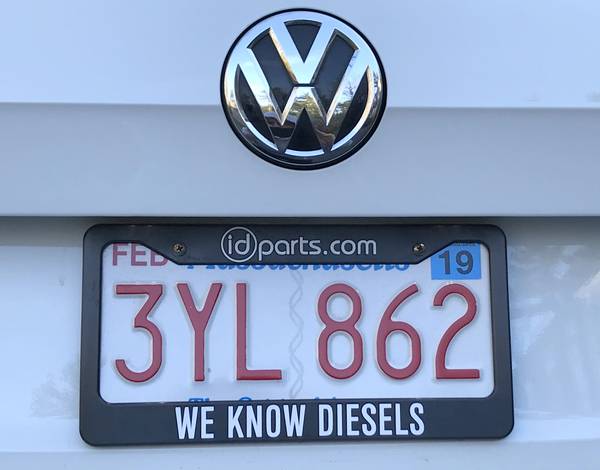

Put this on the GSW (shameless plug )
So Massachusetts doesn't care if the state is covered?

We had some debate about this. It's not clear what states care about this. I haven't had a problem so far, don't expect to.

As of 1 Jan 2009, in AZ it is illegal to obscure "ARIZONA":
"A person shall display all license plates as required by subsection A until their lawful use expires or is canceled or revoked. A person shall maintain each license plate so it is clearly legible and so that the name of this state at the top of the license plate is not obscured."
The fine is $135 PLUS "court fees".
