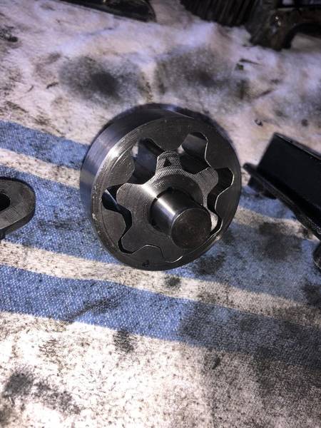

You and I agree, the tensioner and chain are a life-expectancy item. Usually, the sprockets themselves, look virtually new and unworn. I haven't let any go past 400k, but quite a few went 350k without looking too bad.
I don't know why the different color for the gasser pump chain tensioner. Maybe the gasser is supposed to be 'improved'. Can't prove that by me. I seriously doubt it, but maybe the lack of tensioner let the chain slap the pump sprocket to trash, but then, the oil pump is trashed out and doesn't look right, either.
The crescent style pump is a great pump, but this one is not OEM or even close. The triangle stamped into the internal and external rotors is usually a square. The machining marks show the internal rotor is not true flat or it has worn unevenly. The outer rotor is galled. This is a junk pump from China. I wonder who sold it.

Regardless of the oil pump issue I am thankful I still have a block and bores that look very good. I guess you live and you learn, hopefully after frank gets done with my ALH it will go for a long long time and have a little more power
Parts have been sent and I am looking forward to doing business with Franks TDI’s. Frank has been a pleasure to talk with and is very eager to inform you on topics that other companies wouldn’t want to.
