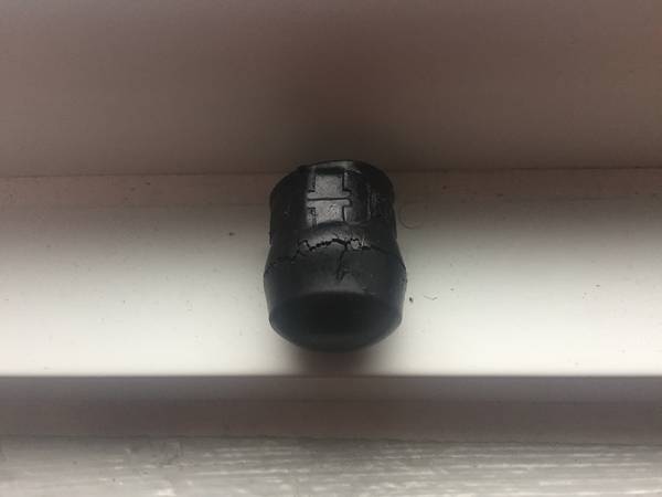

Yesterday was a rather chilly day in the mid 40s and raining. My 70 mile drive to work was uneventful, however upon parking and getting out of the car I could smell the sweet odor of coolant coming from underneath the hood. Popped said hood and saw the coolant ball was empty and coolant all over the top of the transmission right underneath the coolant flange. A quick visual inspection revealed what I found in the picture above. Since the car had the 5spd swap done the distribution pipe that went to the auto trans cooler had been blocked off. The little coolant bypass cap had cracked nearly the whole way around. However it was a slow enough of a leak and the ambient temps were low enough that the car never got above its normal operating temperature.
Ran down to VW today and got a gallon of G12, a generic $2 bypass cap from Advance Auto, and changed it the parking lot with ease. The Stealership wanted $30 for the cap!
