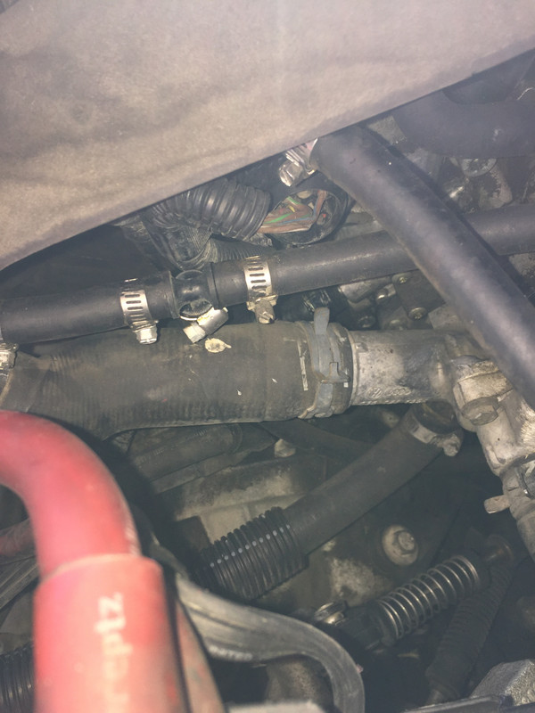

Did 1060 km on the car after my most recent fix. Had thermostat replaced. Now I see a puddle below my car.
edit: deleted the engine oil leak comment... turns out it was a small coolant puddle accumulated below the engine drain plug.

Hard to tell from the pictures. The thermostat housing is at the front of the motor under the vacuum reservoir, behind the alternator. Also, if that is coolant on the floor, it looks green, not pink like G12 or G13, which should be used.

Those are pictures of coolant flange on the side of cyl head. If your valve cover or vacuum pump leaks oil it will swell the coolant flange seal and make it leak. Good time to change seals and coolant temp seal in one shot.

alright, I did some digging around. first off, I googled mk4 jetta thermostat before making this thread and was looking at the wrong spot, I thought it showed the thermostat at the driver side of the motor. guess not, my bad. I was looking at it wrong.
secondly, I just had it idiling for 20 mins while I looked around with a flashlight. it did not get up to full operating temp (90c). it only got to 60c before I was done looking around. I was able to find two spots leaking coolant. I dont know how to describe them so here is some pics. hopefully they show where. I can take more if needed. I drove 500km yesterday, then parked it, and it must of leaked like crazy all night because I came to the car in the morning to a puddle the size of my hand. today it barely seemed to drip. so maybe its worse when its at full operating temp?
the one is on the driver side right by the axle housing it seems. possibly a bad gasket. that one doesnt look easy to fix. its right beside where the frostheater is mounted (see pics)
the other is on the driver side by the lowest belt roller. I cant tell where that is coming from.

Do you see the 3 small hoses clamps? They look like they need to be clocked so they don't rub a hole in the larger hose.

anyways, I will clock those 3 hose clamps so theyre not problems in the future. there is decent amount of space between them, but you got a good point and it takes 5 seconds to do... cant believe the first mechanic would install them like that. my second mechanic (vw specialist) is good and wouldnt do that.
I drove the car 70 miles last night, got it to operating temp, and didnt leave a puddle this morning on the pavement. I sprayed brake clean on the leaking area by the frost heater and am going to keep a close eye on it. I did NOT spray any near the ac pulley because I was scared to get it on the belt.
