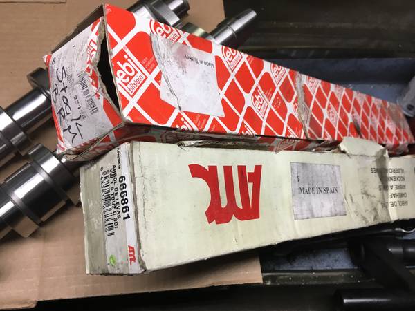

I went to look up two cams that I still have from the time I did my comparison. Dated as they are, some things don't change. Liars tend to continue to lie.
I am still in possession of an AMC and a Febi cam from the same era that my cam grinder made the determination that virtually all PD cams are billet cams. I know things change. They may now say they are made in Spain, but are now made in China. Who knows?
The box AMC claims is made 'In Spain', when the Febi, plainly marked, 'Made in Turkey'.

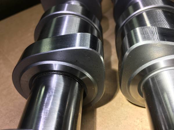

PD Cam Comparing Febi and AMC They are identical. Note the finish of the side of the cam profile and the cam face.
Note the side cut between the injector lobe and the cam lobes..

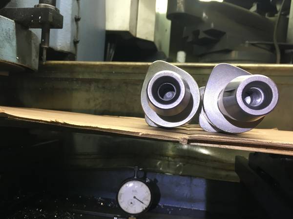

Detail of the tandem pump drive end, down to the finish and the dents..
A look directly into the sprocket end..

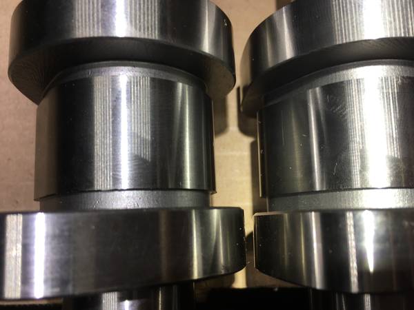

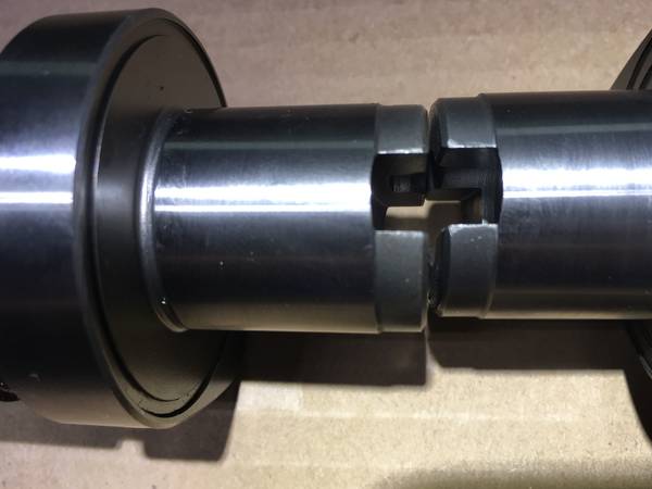

The sides of both cams and their woodruff key slot. If you covered the name, you could not tell them apart. The look is precisely the same.
In these two cams, the chatter from a stone that was not dressed properly is displayed equally into the product, for both the Febi and the AMC cam. I don't have the photo magnification to clearly show that, but examining under 10x will display it. This chatter must be worn away before you can expect the proper mating of cam and lifter to happen. Initially, the cam roughness must be ground off by the Nitrided cam follower.
Contrary to that chatter issue, our cams are finished with a 30 micron paper to smooth to a r.a. 3-4 finish...smooth as glass, then parkerized for an improved break-in.
