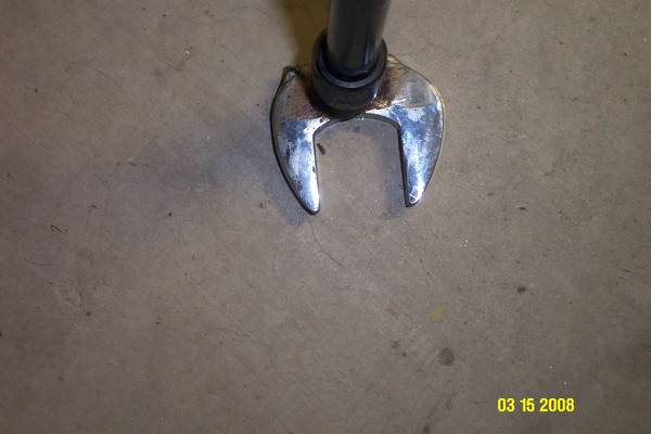

There seems to be some interest, so, I thought I'd post some pics of the tool I made. Others have commented that you could turn the steering wheel such that the rack extends out to be able to put an open end wrench or crescent wrench on it.
At any rate, here's the tool I used:
As I mentioned earlier, I bought a cheap 1/2" drive extension set and wrench set that included a 32mm open end wrench, from harbor freight.
Tony

My inner tie rod was not 32mm, but 33.6mm
Harbor Freight had the right tool for me, for
removing the old joint, and getting the new 32mm
rod in place. I couldn't move it with just a regular wrench.
http://www.harborfreight.com/cpi/cta...emnumber=96558

I’m bumping this for confirming information. The Harbo Freight tool (#63705) is a good bet. The stock tie rods use the 1-1/4” die and the new AC Delco replacement tie rods used the 33.6 mm die. The latter are about 1/2” longer, but the tie rod end (not the end of the inner tie rod, but the ball joint end that bolts to the knuckle) has more than enough depth to deal with the excess. The threading is M14x1.5 for the record.

I bought a crows foot wrench for about $7. Not even worth the time to make one.

You’re correct on this. However, is the rod diameter that critical? The ball joint of both have the same OD. The Bentlies just say to not install the TRW in the ZF racks. I have the new AC Delco parts, but they come with tie rod ends too, not just the inners. You need 1-1/4” adapters for TRW.
I would use a crows foot, but there is an issue. OE tie rods used an 8-point “lobe” so a hex/crow’s foot wouldn’t work [well]. The new ones were rounded square loves and a hex-anything won’t fit. The Harbor Freight tool handles both properly.

I think the reason the Bentley has gone this route is because it would take far too much explaining to the average person about what parts will work with what racks (in reality) so it's just easier to draw the line and say that there's no compatibility.
AFAIK it's really a one way compatiility issue and some folks might conclude without thinking that if it works one way it'll work going the other, and that's not a safe conclusion with this.
Yeah, now that you mention is I remember that some of these use hex fit and some use square. I guess the tool you would need depends on who made the product.
