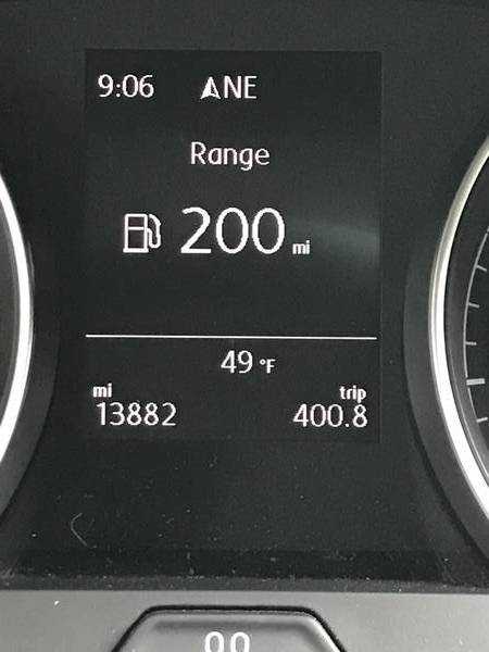

Maybe not apropos of much in this discussion, but I took this photo this AM because I liked the even numbers of fuel used and remaining.
It also shows I haven't driven the car much in the two and a half year's I've owned it.
