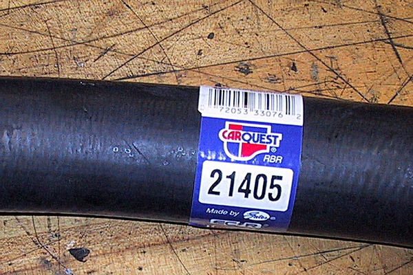

Originally Posted by JetBlu View Post
Originally Posted by JETaah View Post
Here is another choice for a replacement hose.
This one nails the molded angle perfectly.
Something like $11.00- makes 2
Just updating for anyone needing this info.
http://www.amazon.com/Gates-21405-Lo...6866691&sr=1-1
Compatibility Chart
F-250 1983-1987 6.9L V8 Lower w/AIR COND MOLDED COOLANT HOSE
F-250 1988-1993 7.3L V8 Lower w/AIR CONDOLDED COOLANT HOSE
F-250 1994 7.3L V8Lower EXC F ENG CODEw/31" WIDE RAD
F-350 1983-1987 6.9L V8 Lower w/AIR CONDMOLDED COOLANT HOSE
F-350 1988-1993 7.3L V8 Lower w/AIR CONDMOLDED COOLANT HOSE
F-350 1994 7.3L V8 Lower EXC F ENG CODEw/31" WIDE RAD
Autozone part #C71216. FYI. Just blew this hose on mine.
