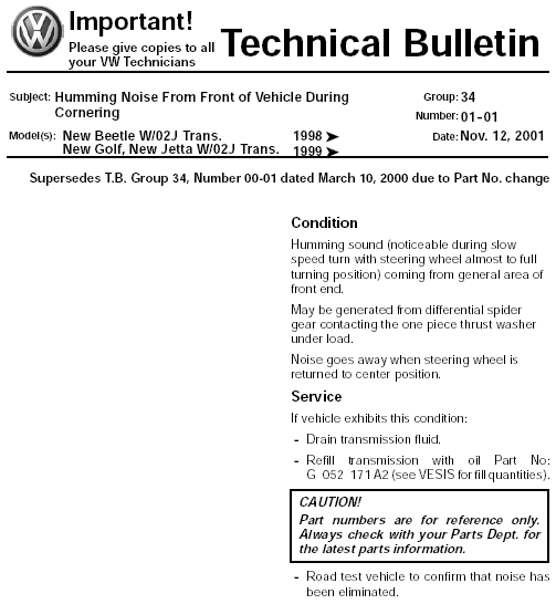

Update: The G52 that addressed the "spider gear humming" issue in earlier 02J manual transmissions is the synthetic G052171A2 that lists for $34.07 / liter (not the mineral based G052726A2).
thanks to karlaudi for sending me this TSB. karlaudi also noted that this Nov. 2001 TSB may have since been superseded.

Okay, so given the date of the TSB, should I believe that there was G52 (synthetic) in my '03 Jetta from the factory, or G50?
Wondering if I'll start to experience the spider-gear hum now with the G50 in there. What exactly should I be listening for?
these are good questions & i don't know the answers.
to me, it seems if you're going to spend the big bucks to get G50, the synthetic G52 is only a few dollars more and it may be the best bet.
my understanding is that some dealers do not carry G50 (special order only) and my local dealer has plenty of the synthetic G52 in stock, so maybe the G50 manual transmission spec. has been completely superseded.

Originally Posted by karlaudi
SUNRG, please. What is in VW's Service Manuals is quite clear.
VW and Audi do not tell you that to select the correct gear oil for your VW / Audi transaxle/transmission/ final drive you must first have an independent lab analysis first, before selecting the "correct" refill oil.
All the oils listed in the Bentley Manual, I previously referred too, are all listed as 75W-90 oil viscosities, regardless of the specification of G50 or G51, and as the oil(s) to be used in the transaxles of the models covered.
What determines what “grade” to use, be it G50 or G51, is the Engine Code. Which varies depending on the year and type of engine fitted. Of the 35 engine codes listed, only one transmission is identified – “5-speed, 02J".
So what about people, like myself who complain of hard shifting in cold weather with the OE fluid??? Am I condemned because the manual states to use G50? I don't think so...
And what about dealers now stocking G52 and putting it in 02J transmissions where the manual also states G50!!??? Obviously, G52 is compatible with older 02J transmissions where G50 was specified otherwise there would be a warning on the bottles or VW would have warned dealers of the consequences. They even put out a TSB for the gear whine fix prescribing switching to G52! The manuals are not always correct.
Reality is that there is one thing that is necessary for these transmissions: a GL-4 fluid. It's viscosity is not a mandatory parameter.
It's a Diesel thing...ladida
pepper10 is offline   Reply With Quote
Old March 29th, 2006, 08:42   #90
SUNRG
SUNRG's Avatar
Join Date: Oct 2003
Location: Roanoke, VA
Fuel Economy: 28mpg@74mph: 1995 Volvo 850 Turbo Wagon
While it is fun to "tinker", taking a single oil analysis "fact" and trying to draw some conclusion about what “correct” oil is be used in a transmission without conclusive "proof" that the “original fill” gear oil is either the source of a present or future problem; when so little of the actual “properties” of the OEM approved fluids is little known; were there are no “control groups”; nor is a "tear down inspection" of the "test" transmission provided; it makes me wonder how you can draw the conclusion(s) you do beyond some desire to find some fault, any fault, with the VW “Factory method”.
karlaudi - you and i don't disagree. from my initial post:
TITLE: stick with (OEM) G52 in ur tranny - here's why...
If your transmission specifies G52 fluid I highly recommend sticking with it as opposed to changing it out for one of the popular/common replacement manual transmission fluids because the viscosity of G52 is much thinner:
Viscosity Comparison @ 100 C
10.6 = Redline MTL 70-80
13.8 = Amsoil MTG 75-90
15.2 = Motul Gear 300 75-90
15.6 = Redline MT-90 75-90
15.0 = Elf Tranself Synthese FE 75-90
16.7 = Motul MOTYLGEAR 75-90
6.3 = OEM G52 (part numbers G052726A2 / G05272601)
**the 75-90 viscosity of common gear / manual transmission oils is IMO not suitable for use in VW transmissions where G52 is specified.**
i am not recommending second guessing VW. i've repeatedly posted that my shifting with G52 was just fine. i personally am experimenting with some other manual transmission fluids - but i'm not recommending that anyone else does. i have stated that IMHO if someone was bent on going with something other than OEM mineral G52 that Redline MTL seems like it may be the most similar after-market option.
you wrote:
(G50, G51, etc.) ... As stated previously the viscosities are all the same.
i took "etc" to mean G52, and the viscosity of G52 is not the same as G50 or G51 - that's all.
you've been referring to your 2002 Bentley Manual. below is page 34-15 of the 2005 Bentley. regarding the two G52s (mineral and synthetic) it states "Viscosity is not specified for either gear oil." i have had the mineral G52 repeatedly lab tested (used sample tested 4x, new sample tested 2x) and its V@100c is 6.3cSt or very close to that. because it is clearly NOT a 75w-90 gear oil i've recommended "sticking with OEM G52 if that's what your transmission specifies" because as AndyH has stated, using a fluid that's significantly thicker than what is OEM specified can decrease performance and increase wear.
