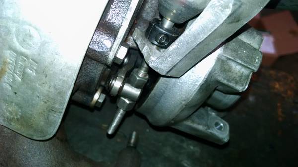

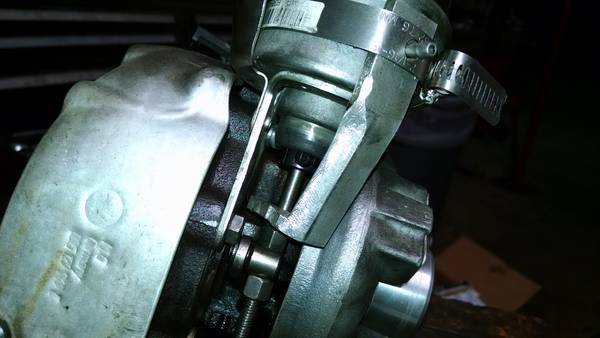

That should explain what is happening and how to see if your turbo is within an acceptable range. I find that a turbo with an OFF-ON range of about 180 mbar should eliminate the possibility that the turbo stop screw is your issue.
I have stopped trying to adjust the stop screw to remedy this due to a couple of times when the cast ear that supports the stop screw broke off while trying to loosen the jam nut. Things get too rusty here in Michigan. Now, I have implemented a bracket and a split collar that can be added from the top side.
