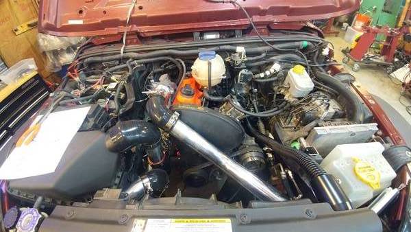

got some things done, going good so far.
got coolant lines run, added coolant glow plugs inline with a coolant sensor for Arduino control. Factory jeep coolant sensor is on other hose.
downpipe and exhaust is all done.

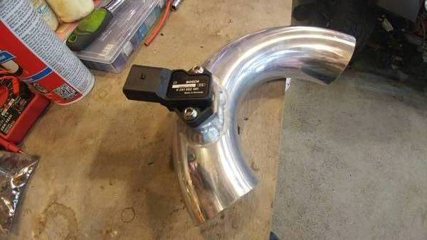

map sensor bung welded on intercooler pipe.
Intercooler mounted, it is a 20 x 7 x 2.5 universal.

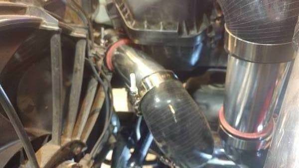

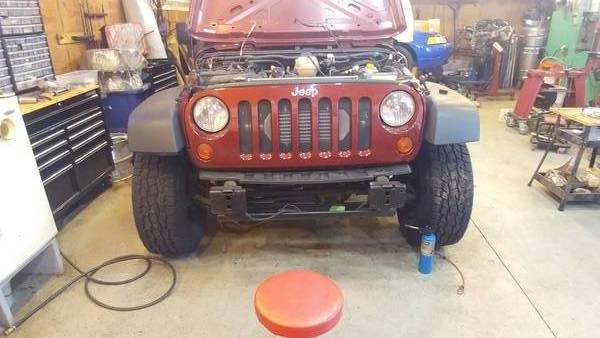

front end back on
intake and intercooler piping done. Had to go back to fishbowl, since jeep overflow was in way of intercooler piping. N75 is on, and all vacuum plumbed.
was able to keep factory air filter setup, tight fit under it for the one intercooler pipe, but was able to maintain the 2.5" piping.
that is is for now.

Lookin good. Where exactly is that map sensor in the intercooler piping? Interested to see how you like the GTB1756VK.
Dodge Dakota QC Tdi
Motohead1 is offline   Reply With Quote
Old March 27th, 2018, 08:34   #44
bwk9087
Join Date: Mar 2016
Location: MI
TDI(s): 2003 1.9 ALH
on the right (driver side) coming out of the intercooler. I don't have a pic of that yet.

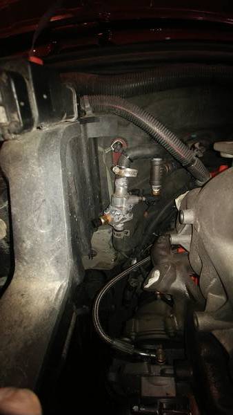

Default 2 small coolant hoses on back of head
I thought I had the coolant hoses figured out, but, I missed one, I took the small one to the top of the fishbowl, where does the one just below it go? the small one seems to be 1/4, and the other 5/16. I was going by this schematic.
