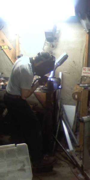

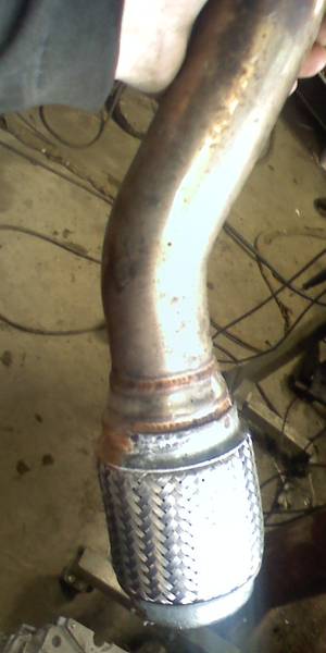

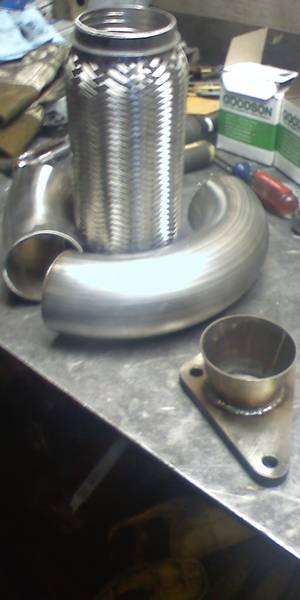

After the business was completed, we installed the hover conversion on the wagon and removed the Techtonics Tuning Downpipe, loosened the rest of the exhaust system to make it flexible, and proceeded to remove the intake manifold, and the turbo.
once we got the downpipe off, it was very obvious why the nuts would work loose and eventually break the studs..
there is no room for the nuts to tighten on the flange, and the welds went all the way to the holes.. durrr...
also, the flex section was very stiff and not very long at all.

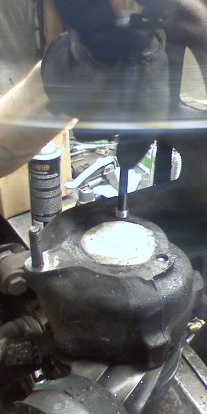

While we had the turbo off of the car, first we fixed the broken studs by Drilling them out and installing 2 helicoils.. we also drilled and tapped the manifold for the stubby EGT probe that came with the car. (right in the two Rs in Garrett)
I have to say, its amazing watching an expert in his field do his thing. taking a pile of random parts, and making artwork out of it.
note the flange section has room for the nuts to tighten down, and the welds do not interfere with the area.
He also has a fuzzy shop pooch to rub your hand on while you watch him do his thing. very friendly.
we finished it up around 10pm and I have to say, the exhaust is connected to the turbo properly for the first time since I have owned the car. It was starting to give me headaches every time I drove the car anywhere due to the loose DP connection.
Thanks a ton Matt. your work is awesome!

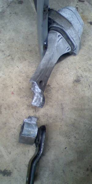

Last Wednesday 5/11/11 I had been noticing some extra vibrations when accelerating, and harder shudders upon shutdown. I figured something was up with my dogbone but hadn't had a chance to investigate. after leaving my sons Piano practice, not 500 yards down the road my coolant temp light beeps & flashes at me. I quickly pull over and check the level.. its empty in the bottle.. yippee!!
I carefully nurse the car around the corner to the nearest walgreens and purchase two gallons of Distilled water to nurse the car home on as I noticed a slow leak coming from the passenger front area of the car.

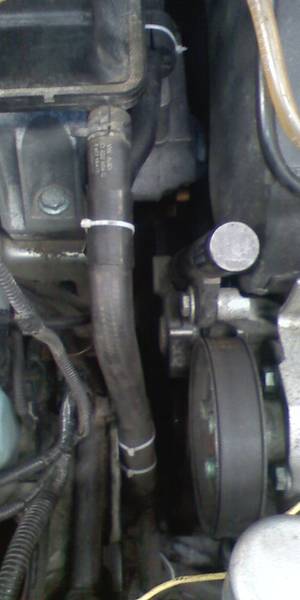

after a couple of stops for refilling, I made it home and tore into it to try to figure out what happened. with the help of a good friend/customer of mine, we got the entire nose taken apart to find a nice hole cut in the small hose that goes from the coolant bottle to the metal pipe under the IP.
we also found the busted dogbone mount..
Broken Dogbone, worn out rubber donut is root cause. allowed too much movement, and it broke the casting.

fast forward 400 miles until monday evening when the correct hose arrives from impex on the big brown truck, and my bro in law & I commence putting it back together.
here is a shot of the new hose, routed and ziptied properly, back in all of its holders, no longer getting into the fans.. oopsie!
It only took a little over an hour to get the car reassembled completely. I noticed less vibrations when taking off in 1st, and no more coolant leaks. so thats a good deal!
