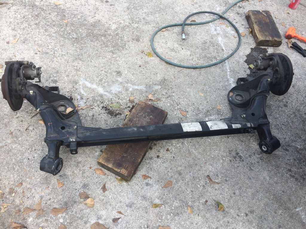

I installed new Cupra R rear bushings (6LL 501 541) it was easier to remove the rear axle. Not an easy or fun job! It's back in place with new brake pads & rotors to match the front. Also got Shine Racing Real Street Springs and Bilstein TC shocks.

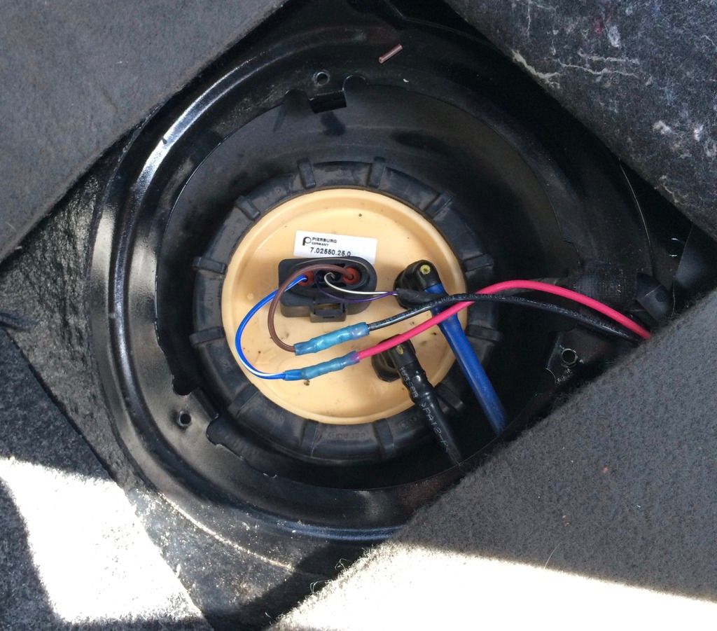

Installed a PD Lift Pump

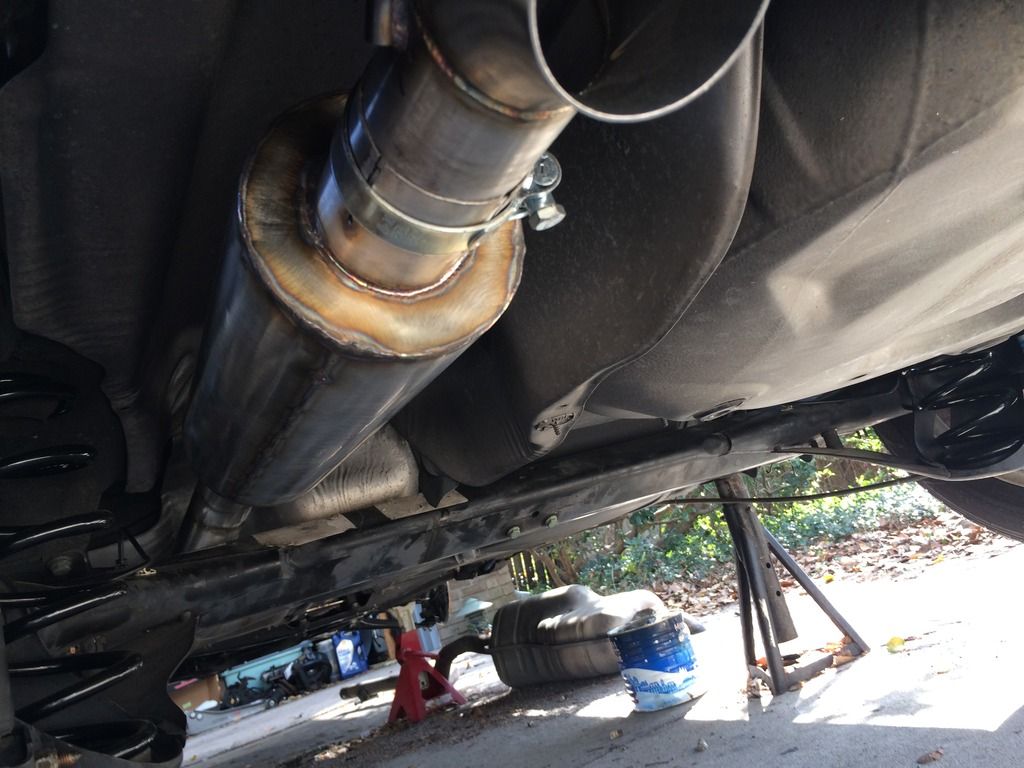

and a 2.5” stainless steel downpipe & tailpipe

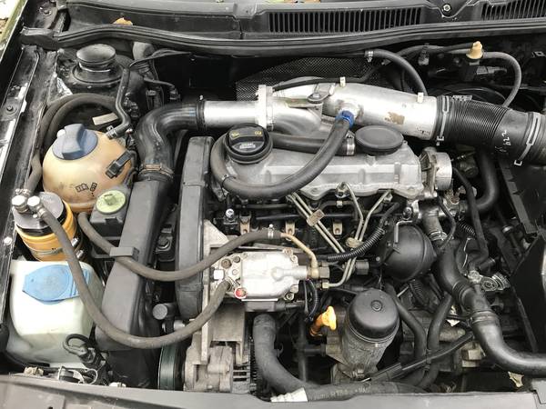

Still sorting out the PD150 vent pipe, I think I have a solution. It actually runs now, in fact I drove it around the block last week.

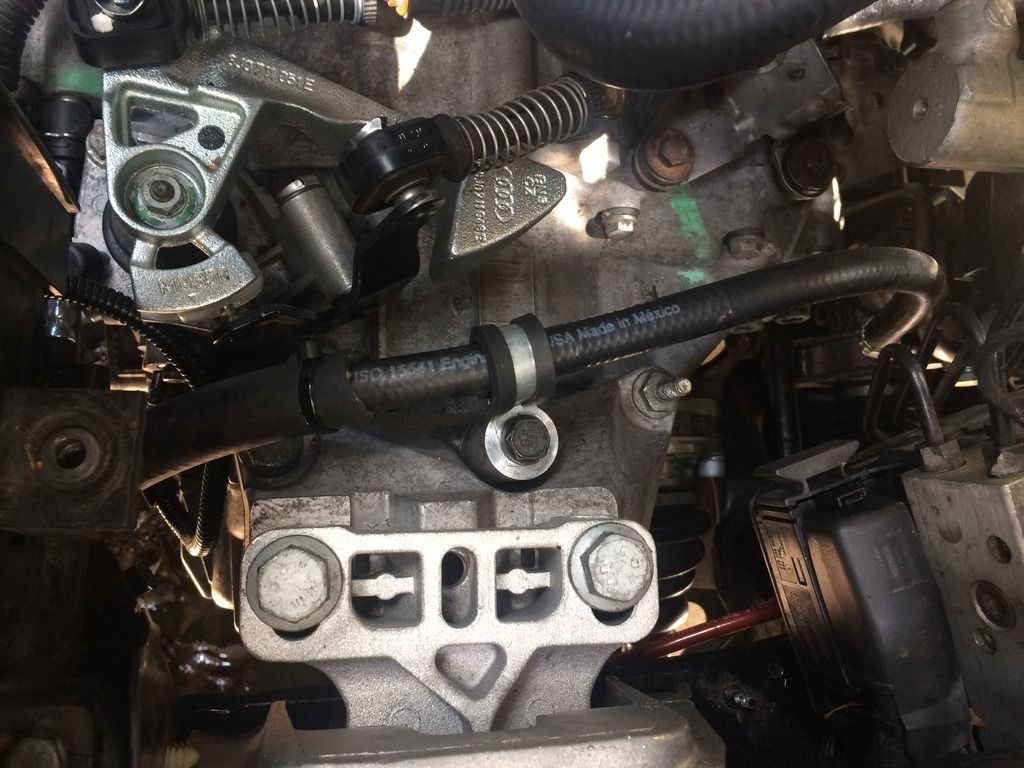

One thing I did was to have a flexible line installed on the power steering hose. They cut the steel line and welded on AN fittings. Then made a hose with AN hose ends to connect the metal pipes. Makes running the PS hose around the 6 speed a lot easier. The clamp is on a 1.5” tall standoff bolted to the transmission mount. I like it a lot better than trying to bend a 5 speed hose to fit.

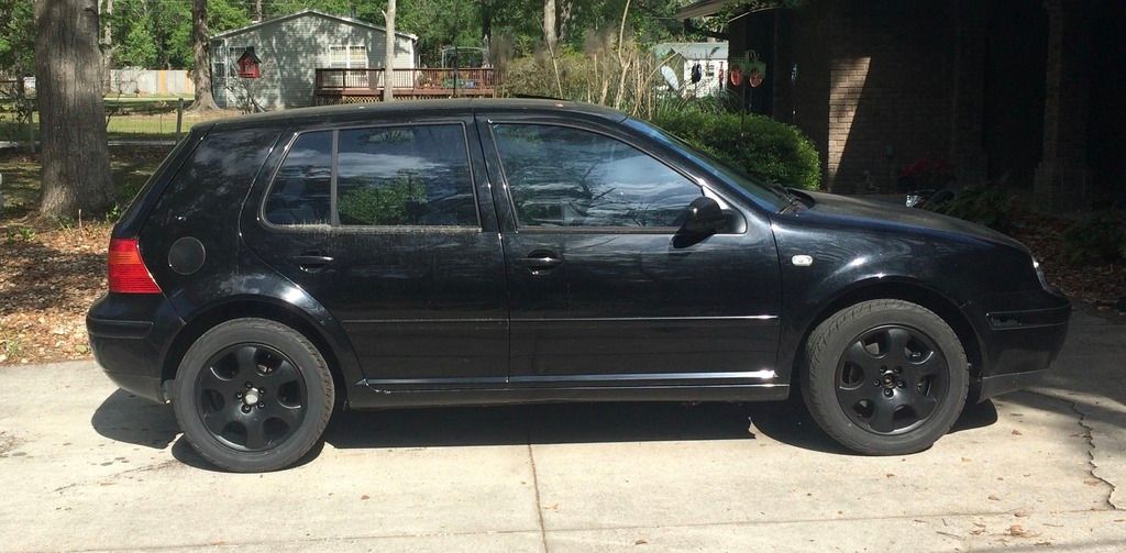

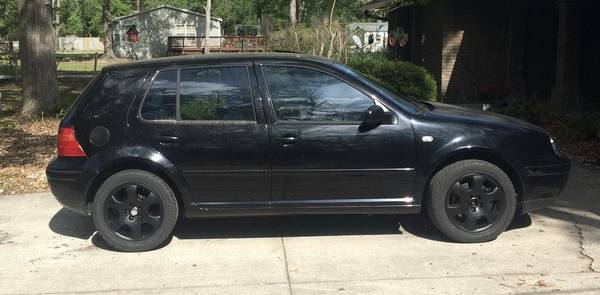

And here it is off the jack stands! The wheels are powder coated Force with 205/55 16 Yokohama S Drive tires. Haven't installed the wheel centers yet or even cleaned them up from mounting them. Started on the interior, the headliner is out at the upholstery shop.

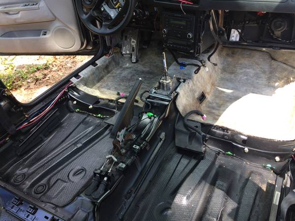

Another busy weekend, but not much to show. I got all the black interior parts from a parts car. Stripped out the interior of the Golf. It's probably good to good clean every 15 years or so!
Interior all out. After this pic was taken, I put the black carpet in along with a few interior bits.

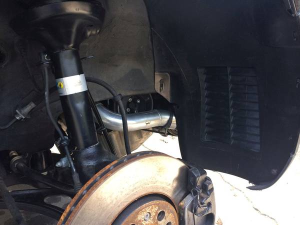

Installed a vented fender liner from a Jetta City.

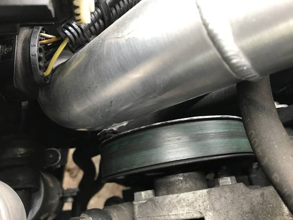

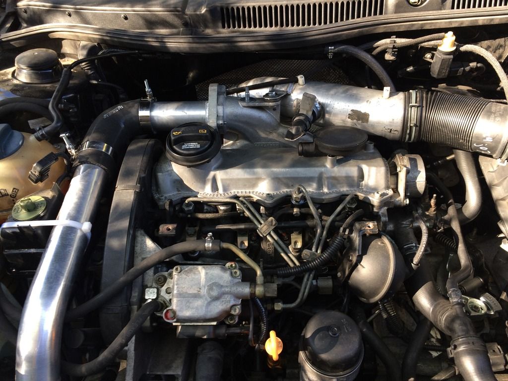

I discovered my aluminum upper intercooler pipe was hitting the power steering pulley. It has good clearance, so I guess the engine is moving a bit.
I've installed a Nicktane filter in place of the stock fuel filter.
It didn't go all the way through - but it's close! I'll probably have it tig welded up and should be OK.
I've ordered a set of Vibra Technics dogbone bushings. Hopefully they will reduce the engine rocking but won't transmit too much vibration. I guess I'll find out!

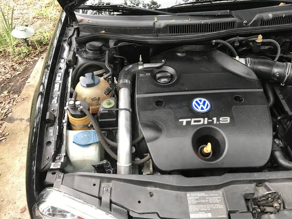

I installed the stock pipe from the IC to the intake. This pipe fits better and really I don't think it's all that restrictive.
I'll see how it does, but if I don't notice much difference, I just may keep it. I like the stock appearing engine compartment as well.
I'm not 100% decided on the crankcase vent hose. The way I have it now works, but I'll probably do something else later. I'm still considering a Mann Pro Vent at some point.

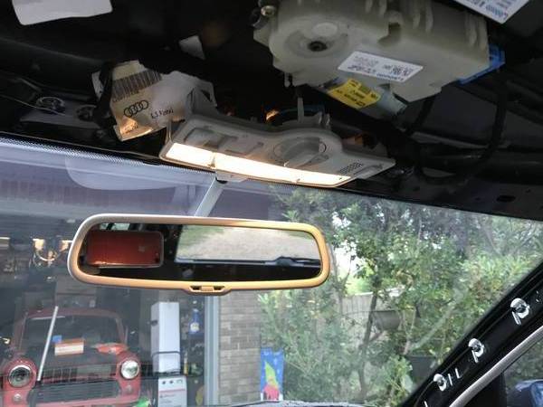

I've got another project that will take the next few weekends, but I managed to get a new windshield and a rain sensing mirror installed. It works great.
The mirror is auto dimming and has the red "ambiance" LEDs that shine down.
And while the headliner is out, I resealed all the sunroof drains. I had a small drip from the left front one, but no more. We have had some good storms, but all is dry inside!

Where did you find the vented inner fender liner and how much was it? Thanks!
Awesome work by the way!
2004 Jetta TDI 183k mi
2010 Jetta TDI 155k mi (Fix Completed 12/17)
2015 Jetta TDI 40K mi (Did the buyback on 2/17)
2015 Golf SportWagen 4000 mi
THIS WILL MAKE YOU CRY!
GIDDY_UP_GO is offline   Reply With Quote
Old August 6th, 2017, 07:18   #44
NarfBLAST
NarfBLAST's Avatar
Join Date: Mar 2002
Location: Waterdown, Ontario, Canada
Fuel Economy: 5.8 - 4.5 (40 - 52)
OEM part number is 1JM809962A which you can find at your local dealer or many places online such as here: http://www.idparts.com/vented-fender...a4-p-1063.html

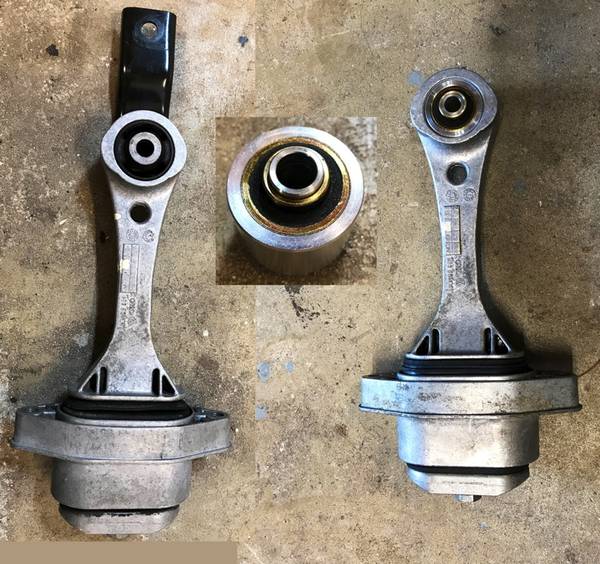

I installed a Vibra Technics dog bone bush and insert. They are nicely made pieces. I went with the Vibra Technics because I prefer rubber to polyurethane for mounts. You reuse the aluminum mount, replacing only the original rubber ends. It is adjustable, but I can tell you the firm is just that. It transmits a lot of vibration to the car. The "comfort" is much better. Still a little vibration at idle, but not too bad. It does seem to help with the engine rocking, the car feels firmer when accelerating to getting off the power. I would say it is a worthwhile upgrade.
The stock mount is on the left. The middle is the small end bush. On the right is the finished mount, ready for installation. The black support brace mounts to a machined step on the small bush. You can see the step in the center picture.
