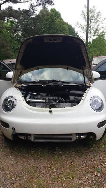

After far too many months of down time, I finally got an afternoon free to work on this car. For starters, the boost issue turned out to be a failed clip on the turbo outlet, so the adapter worked itself out. Easy fix!
Second, the PD150 manifold is now installed. Please excuse the dirty engine bay! We're in the middle of pollen and thunderstorm season here in Georgia, so all kinds of detritus has ended up on and in my car.

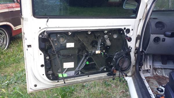

I also installed the manual window regulators. Modified door panels will follow ASAP.

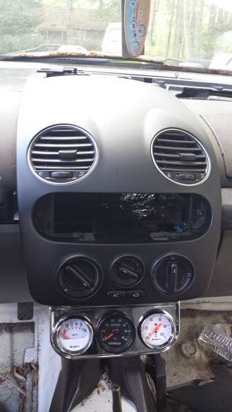

And last, for now, I got my new dash center section installed with a gauge pod. For now, only the boost gauge works. The voltmeter will be replaced by an EGT gauge.
Next order of business will be to install my Neuspeed rear sway bar. I also have a change of rolling stock in the wings. The characterless black wheels and big stupid 215/55-17's are driving me crazy.
