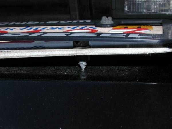

At a Boston area GTG this morning, several of us were shocked and appalled to find that our dealers screwed our rear license plates on with self-tapping screws so long that I'm surprised tightening them didn't shorten the car's wheelbase.
The immediate downside of this bonehead maneuver is that it puts four little dings in the paint, caused by the plate flexing when you close the lid or hit a bump and the tip of the screw hits the body. This is where the hatch or trunk lid will begin to rust.
I just touched mine up and put some temporary rubber spacers between the plastic plate mount and the body until I can get proper fasteners on there that do not dig into the body. Sheesh.

I had the exact same thing happen with my 2009 JSW. I went back and complained to the GM at the dealer (I just happened to catch him putting a rear plate on a JSW - he was using shorter screws, BTW). Anyway, the end of the story is that I got the dealer to give me a free touch up paint kit. It consisted of a color paint "pen" and a clearcoat "pen". I probably could have made them fix it themselves, but I would rather have the touch-up kit around.
In other words - They caused the damage, they should pay to fix it! Either get them to touch-up the paint or get some free paint out of them. (just my opinion)

there is a plastic mounting bracket on the back of the car. It's attached to the vehicle in the center area. On each of the four edges of the plastic rectangle are holes for mounting a plate. The dealer is using screws longer than the distance from the car to the front of the mounting bracket. The result is that the screws end up being tightened into the body of the vehicle instead of just holding the plate to the bracket.
So as they tighten the screws, it's turning and getting closer and closer to the car till it's turning into the paint!

I don't have any pics, but here's the deal. There is a plastic license plate "bracket" that is firmly bolted to the rear hatch. This is not the problem. The problem is that this plastic piece is less than 1/2' away from the car's body where the mounting screws go in. When you use 5/8" long sheet metal screws the point digs into the paint on the rear hatch. I noticed this the first day I got the car home because I tried to remove the dealer installed advertising license plate frame. It digs into the paint even worse with no frame (it acts as a spacer).
My "fix" has two parts:
1) Buy a TDIClub license plate frame (and support this site).
2) Grind about 1/4" off the length of the screws, you don't need that sharp point on the end (you could also go buy shorter screws, but I'm cheap).

One of the first things I did when I got my JSW was to get rid of the dealer supplied screws and replace them with some stainless steel ones from the hardware store. Not only were the dealer's screws too long, they were two or three different sizes and plain old zinc plated steel. At least now mine won't rust away within a year.

Thanks for the heads-up on this... my JSW also had the screws that were just too long. Thank goodness the indent was very minor. I'll grind a bit off and use some washers with my club frame to take up the difference.
