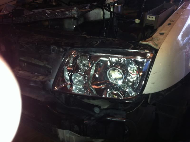

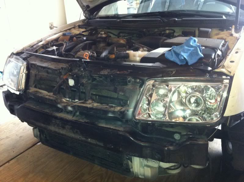

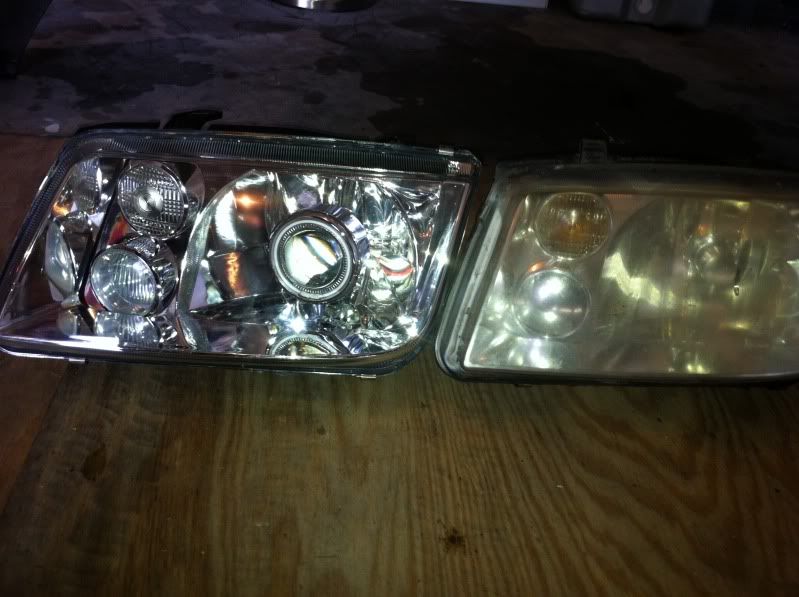

I went over to Jeff's yesterday and got my lights installed. I believe this is the 1.75 style with the new 55w ballasts. We went the route of using my oem housings and installing his new projectors into my existing housings. I don't care too much about the city lights/parking lights or euro switch etc, I just wanted a lot of night visibility. (Most bang for buck, most oem looking). I splurged on getting glass lenses though, just had to.
A few hours later, I have an amazing amount of light at night. Jeff really knows what he's doing with these headlights. The wiring alone would've been too much for me to attempt on my own. I was lucky he only lives about 15 miles away and wanted to help out a fellow tdi'er. He went above and beyond to get these fabricated and installed correctly and I would recommend him to anyone. I can't stress enough what a good value this is. Considering Silverstar Halogen bulbs etc could be $50+ a pair and won't give you a fraction of the light that Jeff's lights do, this is really a must have for anyone who likes to see at night.
He also helped diagnose a weird sound coming from my timing belt area, which turned out to be my timing belt cover not being attached securely. Thanks again Jeff!
