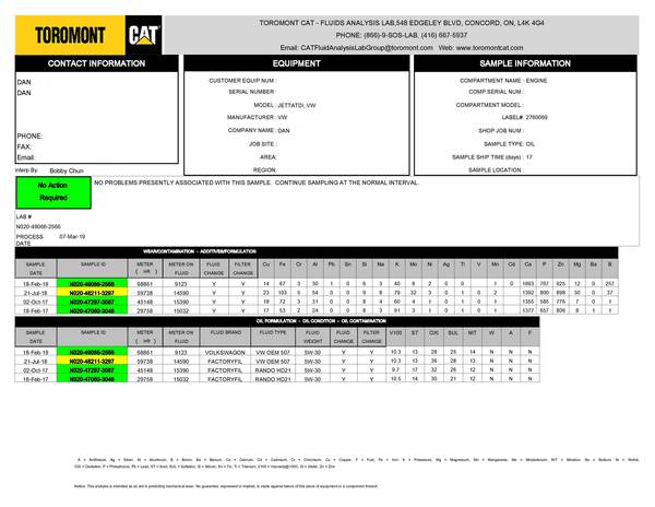

Looking a bit better but it only done 2/3 of the interval before I changed the oil. Hefty boron package in the oil. Seems like good stuff
