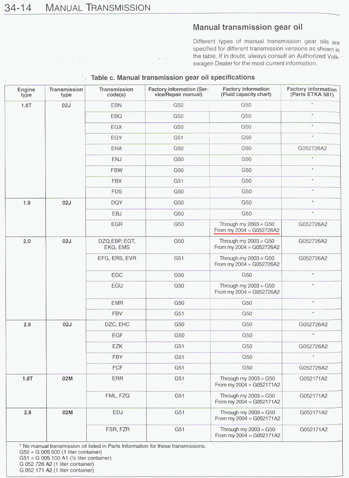

you've been referring to your 2002 Bentley Manual. below is page 34-15 of the 2005 Bentley. regarding the two G52s (mineral and synthetic) it states "Viscosity is not specified for either gear oil." i have had the mineral G52 repeatedly lab tested (used sample tested 4x, new sample tested 2x) and its V@100c is 6.3cSt or very close to that. because it is clearly NOT a 75w-90 gear oil i've recommended "sticking with OEM G52 if that's what your transmission specifies" because as AndyH has stated, using a fluid that's significantly thicker than what is OEM specified can decrease performance and increase wear.
SUNRG, Cool Chart!
I currently only have the CD-ROM Manual and this chart I do not believe is listed. The viscosities that I quoted are listed with the General Specifications, Technical Data and Capacities section for the Manual Transmissions. VW/Audi Part Numbers for the various gear oils are not listed in this section.
I wrote "etc." because, although G52 was never mentioned, it was in the TSB I provided and I did not have either an updated CD-ROM or the latest hardcopy manual. Experience indicated later manuals would most likely list it.
We may both be on opposite sides of the same page.

I picked-up my liter of G052171A2 today. I also got what I thought was going to be my liter of G052726A2 and when I looked at the bottle in the car (I don't recommend reading transmission fluid bottles while driving down the interstate at 75, by the way...!) and it's G055726A2. Ahhh...what's G55?!
G55 must be the really-REALLY-ultra-mega-mega OEM gear oil

I also got what I thought was going to be my liter of G052726A2 and when I looked at the bottle in the car and it's G055726A2. Ahhh...what's G55?!
perhaps the G52 726 has been superseded with the G55 heh...
