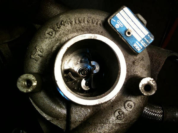

There seems to be the occasional >2004 that is grenading the turbo, blocking off air flow. This failure starts with a pop while driving, and the car dies, then it won't restart. A test is to remove the air intake hose where it goes into the intake manifold. If the car now starts, pull the hose off of the turbo and take look in there. If it looks like this:
it's time for a new turbo.
