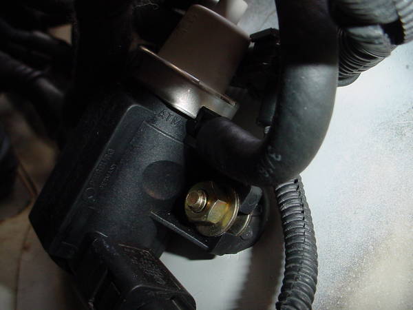

passenger side engine mount, driver side tranny mount. how you mounted the various mk4 solenoid /valves (n249,n112 etc) for the engine.

The grommets are mounted to the rain tray. There's not enough room to get a power tool in there, I'll tell you right now.
