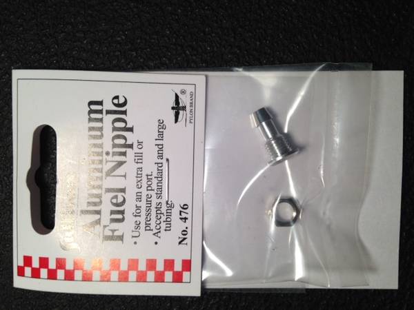

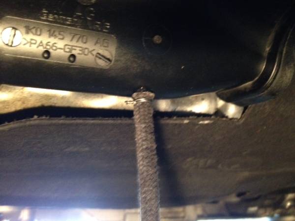

Originally Posted by TDI57 View Post
My fix, drain it away.
IMG][/IMG]
Update:
Temps have dropped in Columbus OH.
Last night I raised one side of my car to switch to winter tires and heard what sounded like a water leak. Thought is was odd until I thought of my drain hose. Sure enough I checked and water ran out onto my metal drip pan on the garage floor. It was a substantial enough volume to hear dripping into the pan, at least several tablespoons worth.
So glad I have that simple tiny hole. Works as I expected. It is a really good feeling to see that water come out rather than stay in the system, potentially causing hydro-lock.
For the few of us keeping our TDI's, I highly recommend this simple trick.

Did you order the fuel nipple from here?
http://www.sullivanproducts.com/Sull...et_Catalog.pdf
Page 8 of the PDF
Chris
Page 8 of the PDF
Yes I did. Great company, I described what I was looking for and they actually shipped to me for no charge!

Originally Posted by bobt2382 View Post
....please let us know how everything works out.
Wow! That was crazy scary...I went from engine is F'd to it runs fine in 5 minutes. Was warm enough today to remove the plugs and crank the engine over. Also pulled the bottom cover and drained the lowest IC hose. It now has a 1/8" hole in it as well. This will not happen again. Car needs to make it to February for buyback.
See link for pictures:
https://goo.gl/photos/fc6G57QieKNhnsae9
Sent from my iPad using Tapatalk
