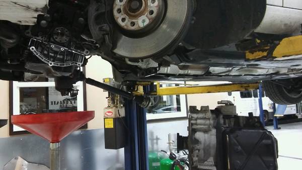

And since my last post.... another blown rear main seal.
I'll tell ya, these are becoming a weekly thing. This one is an easier one, a 2009 Eos w/ automatic. So it is FWD/DSG, the easiest of all the transmissions bolted to this junk engine to remove. Oh, and its water pump is leaking too. Has not even made it to 100k miles.
