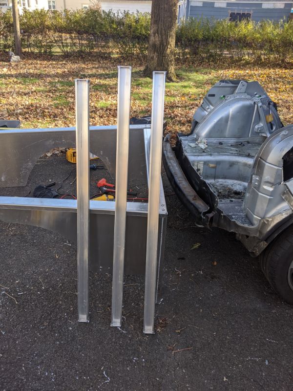

Time to talk about cutting the bumper. There are a couple Golf-specific issues here.
In the Jetta videos, there doesn't appear to be much in the way of cutting at the height of the flange/seam that runs down the middle of each wheel well. Looking at the Golf, however, there is this bar of sorts above the bumper support. It isn't much in the way, but it meant that I couldn't follow the video to a T. What I did do, however, was use that bar as a guide and just cut right up against it.
And here is the rear end with the main bumper cut done:
I figured it was time to test-fit the bed sides:
Something looks...wonky, huh? Well, the most significant Golf-specific issue quickly became apparent: The heavy steel bumper is too high to allow the bed sides to settle in place.

Knowing a sawzall would't be up to snuff and worried that I was just missing something, I reached out to Mark Smith (again, extremely helpful). He confirmed that, yes, this interference is supposed to be there and that the best approach would be to cut two notches into the bumper for the bed sides to fit. So I ordered a 4.5" angle grinder and a diamond-edge cutting blade.
Mark suggested drilling a 3/8" hole at the bottom of the anticipated cut and then cut a V down into it to make room for the bed side. A 3/16" cobalt bit followed by a 3/8" cobalt bit made short work of it.
Time to pull out the saw and watch the sparks fly. My aim was pretty off on the passenger side, so my notch is wider than I would have liked. At the end of the process, this is what I got:
I was able to get the bed sides to settle in properly and made some more side cuts to get rid of extraneous material before assembling the bed frame. I ultimately ended up cutting away even more of the material below and to the right of the filler nozzle than is pictured here to make room for the Jetta fuel door that will go into the fiberglass panel later.

Assembly of the bed frame is fairly simple. Most of the bolt holes just have pilots that need to be drilled out to 3/8". The front wall gets attached to the bed sides with 4 bolts at each upper corner, 3 more through the wall on each side. Then come the cross bars. Here they are left to right from tailgate to front wall:
The first one is shorter because it fits under the tailgate area where the bedsides jut inward. I tightened the nuts down just until the nylon inserts started catching. I am sure I could have gone further, but I am trying to maximize my margin of error. And here is the assembled bed frame:
A buddy helped me lift it into place and voila!
We couldn't resist a chance to hang a couple fiberglass panels on to get an idea of what the final product might look like:
Next steps will include a thorough cleaning of the spare tire area, rustproofing of exposed edges, assembling the tailgate, and sorting out the b-pillar braces.
