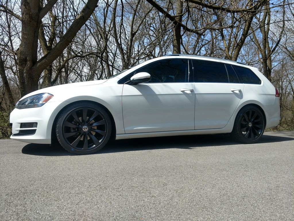

H&R Sports (correct ones for our TDI)
Sent from my Pixel XL using Tapatalk

Looks good. I went with Neuspeed for my GSW.

Nice, I ended up switching to H&Rs as well. I have the same Quickjack as well, perfect for pretty much any job!
Love the wheels! Details?
They are Konig Oversteers in Opal color, 17x8 wrapped in Continental SureContact 235/45ZR17 tires. It's my #dadwagen so I opted to stay with the 17in wheel and meaty tires. If I was a younger man with less need for "utility" I would have gone with the 18's but these look good, right great (38psi) and have LOTS of rim protection so I'm quite happy with the decision.
