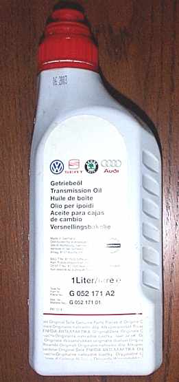

Originally Posted by david_594
..... Im running the G52 in my 2000 Jetta. Smoothe as melted butter when warm, but when it gets cold it feels more like a frozen block of butter.
Use G052 synthetic and it will be the best it can be when you have sub zero temperatures.

Originally Posted by SUNRG
supposedly, the fully-synthetic G052171A2 is what was in the MK5 GTI 6-speed manual i test drove the other day . that shifted fine - though i did miss one downshift (probably my fault).
cheers!
I put it in my NB a couple of years ago.
It stopped my spyder gear hum and shifts excellent in sub zero temps..
Frank, do you still have any of this oil left over? If you do would you be willing to send out a sample for testing? If you dont want to/done have any I would be willing to order a liter of it to send out a sample from.
It seems like this would be the next logical step in our testing. Right?
the pic of this empty container was taken a couple of years ago.
i have sent the container to the recyler.
sorry
