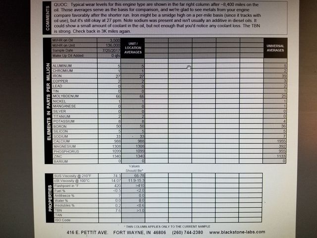

My report shows high sodium. I run WVO in my TDI and use salt as a de-watering step. Could that have gotten into the engine oil and could that harm my engine? I also use the Delo 5w-40 and my OCI is 3k - 4k. This report was done at 3.5K

Yes, the sodium is likely coming from your fuel. WVO isn't doing your injectors any favors either.

We've had so many years of experience with WVO in TDI engines, and those experiences are almost always bad. Short OCIs help, but they do not prevent the fuel from contaminating the engine oil -- and no matter how professionally the WVO is processed, it is still harmful when it mixes with engine oil. WVO is usually fine in indirect-injection engines, but not for our direct-injection engines.
This used-oil analysis is a warning, which should be taken seriously.
