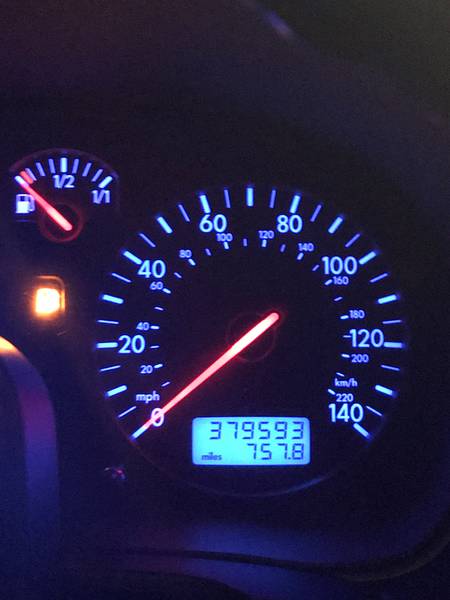

Those are all highway. Here's a tank from a couple weeks ago with commuting, some traffic, fair amount of low speed suburban driving:
That one was 47.2.
I forgot a tank from the weekend. Average was actually 46 even. I had one bad tank driving 80 MPH into 30 MPH headwinds. And driving around downtown Madison WI in the snow. That tank was right around 44.
