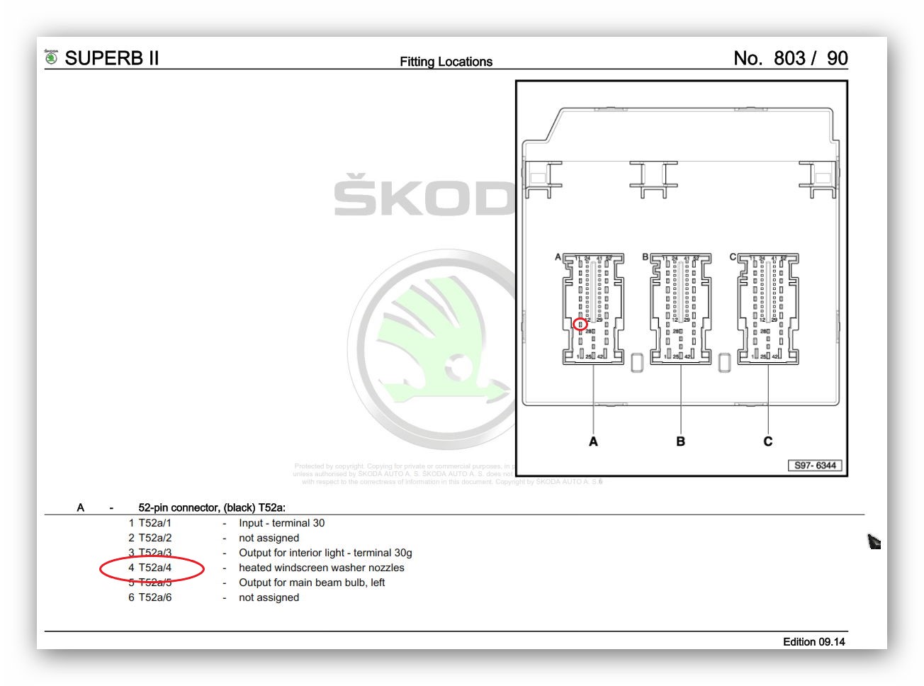

I am looking for a terminal pin for a pin4 on a Superb II BCM to connect heated windscreen washer jets.
Are they
N 103 358 07 / N 000 979 131 or N 906 844 05 / N 000 979 133?

000979131E are very small pins. 000979133E would be the larger size ones used for a higher current like for the heated jets. Presumably the numbers you quote are the possible size pins used with that particular terminal plug.

Below I have inserted a snapshot of the BCM. Looking at pin 4 on socket A would you say that it is a 000979133E terminal?
Edit, the copied picture appeared as text.
Can I upload an image from my PC?

This is the screen shot of the BCM I tried to upload earlier.

Might be easier to just unplug it and have a look, but looks to be the 131 size in this case!
