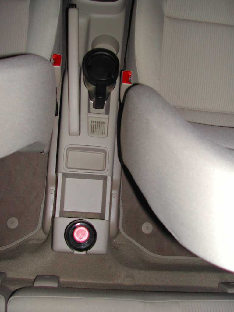

This is the assembly I have... Not sure where that single slot cup holder goes or if it is necessary since I have (9) the sliding cup holder and (6) the little cubby.
I wouldn't mind keeping those two if possible or replacing the cubby with a "cap."
Anyone have a schematic for the 2004-05 models?

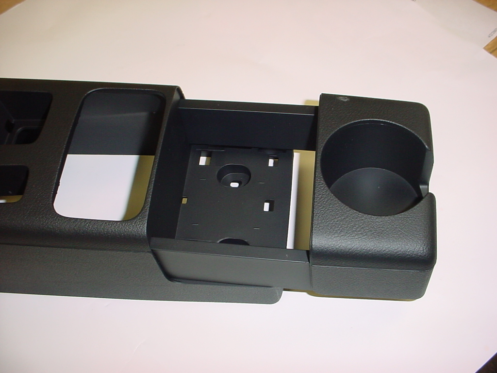

Now, the confusion I had was about the "cap". The cap is the plate that covers the screws in the rear of the console. Here's a picture that shows the console + rear cup holder _without_ the cap:
Here's one _with_ the cap:

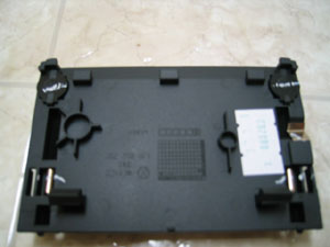

And lastly, here is the actual cap:
Note the little yellow 'gear' in the top picture. This is what makes the rear tray 'glide' out and in. Without this piece, the rear cup holder is loosely held in place and not useful if pulled out to the rear.
