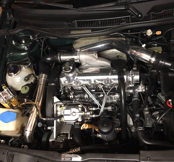

Originally Posted by terrydtdi View Post
Here is a pic of my engine without the vacuum ball.
SHINY!
Originally Posted by Nevada_TDI View Post
Are we talking about the same check valve(s)? I was referring to the one in line from the vacuum pump.
Yeah I was referring to the vacuum line. Are we actually referring to the coolant line?

Anyone know what egt probe to use in the gtb housing?
Wow! So fresh and so clean clean.
PS: Fraggy, great work so far!
Thanks! Are you in huntersville, mn?

Originally Posted by turbovan+tdi View Post
Where's the LIKE button, so clean and shiny,
What did you use for the return?
Formed silicone hose shrouded with high temp wrap.
