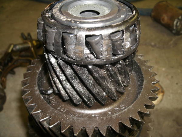

This transmission was recently shipped to me and I finally had a free moment to open it up. The pics speak for themselves.
These are parts here from a properly oiled 5 speed. Notice how everything is "wet". It was even shipped empty across the country to me just like the 6 speed was.
Now, here's the 6 speed I just opened up. Notice how "dry" everything is.
Notice lack of oil pooled anywhere
Plastic parts of reverse synchronizer melted from heat
Final drive #1 bearing race
Final drive #1 bearing. The roller cage was actually welded to the race in the case and took me about 40 mins of french, prying, slide hammer, and wiggling to get it out.

I suppose I should've clarified further in the first post. This trans came from RyanP, was installed by a shop, locked up shortly after installation, then was pulled and shipped to me to see what happened.
Anytime a trans is ran, pulled, drained, and then shipped, it will always be "wet" inside. The first pic I posted of a 5 speed that was shipped to me for upgrading is a perfect example; notice the coating of oil on everything even though it was empty when it got to me. This 6 speed was BONE dry inside with the acrid odor of burnt gear oil.
so, that trans is garbage then? or can it be rebuilt?
At bare minimum it needs all new bearings and syncros. Hopefully a brass brush will clean all the crap off the gears and they'll be ok. Whether that's cost effective or not, now that's a different story.
