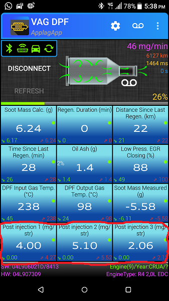

Another thing i found on CRUA engine on my 2015 Golf TDI is post-injection 1 phenomenon.Engine does it all the time under partial engine loads,even if your engine,dpf are fully warmed up and at normal operating temperature. I believe its an emission thing but sure fuel economy killer.I was under impression that post injections are done only during engine warmup phase or during regens.
Any links to this? Not doubting you, just interested in something to read.
I wasn't aware it's dumping fuel all the time...
Sent from my One using Tapatalk
Sorry i don't have any links.I am just describing what i am seeing in the data i collected. Maybe some tuner can shed some more light on it.
Post injections can be viewed in real time by using Vagcom or ODIS-S(vw factory diagnostic software) or with vw specific app.I used VAGDPF app.
As you can see in the above posted screen-shot,engine was just started in the morning and was in warmup phase.You can see all 3 post injections were active to warmup emissions components faster(economy killer).
Now in the following screenshot,Engine and DPF are fully warmed up and you can see post injection 1 was still active.This is the post injection-1 i am talking about.But i noticed that its greatly dependent on your throttle position.I could see my MPG display dropping a little as soon as i see post injection-1 under normal driving conditions.Also on under hard acceleration,this post injection -1 phenomenon doesn't happen.

What module? There's oodles on the web. I'm sure there's Chinese junk using the elm327 chip.
