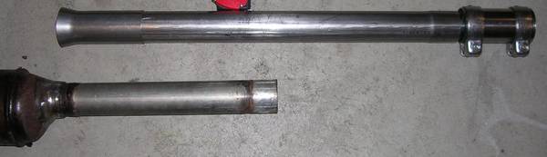

Those are indeed very good sources. I ended up buying two pieces from mandrel-bends.com This was my order:
2 x 2.13" OD, 16 Gauge, 304 Stainless Straight Tube
1 x 2.25" to 2.75" Transition Cone
1 x Expansion Service
I got lucky and the straight pipe fits inside the transition cone. This will not always happen but they can still be butt-welded. I ordered 2 feet of tube but you can see from the picture that I only needed 1 foot.
I asked them to expand one end of the tube to 55mm OD so I can use the OEM clamp. You can see the expanded area adjacent to the clamp in the picture.
next stop - the local weld shop! I'll have them fixture around the old pipe and then cut it off so the new pipe can be exactly where the old one was - at least that's the plan.
This should come in under $100 total for the repair.

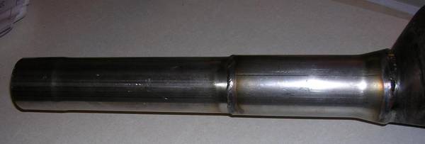

Finished!
Dan at repairspecialties.net in Johnson Creek did the welding of the 304 stainless part for me. He created a simple fixture to make sure the pipe's alignment was the same as the old one. Looks good to me! now it should be a simple bolt-up job.
He said he had to do a bit of filling at the end of the transition piece but that is the best part I could find .. and I looked at a LOT of places!
