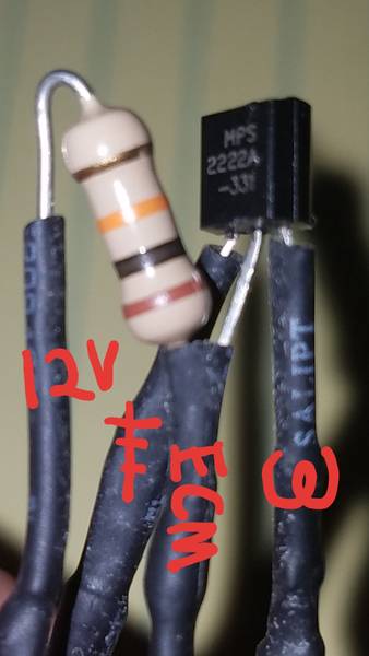

121 ecm interface pin/wire chart:
component:...........pin color
CEL:...................24 ws/bl
tach:.....................27 gn/br
glow:.....................40 bl/gn
vss:.......................20 bl/ws
k line:....................16 gr/ws
clutch cancel:..........66 ws/ro
BS n/o:...................32 ro/sw
BS n/c:...................65 ws/ge
"wake up"
(key O/S):...............37 sw/li
hope this helps
this is to correct the reversed function of the cel when using pin 24 as the source ...credit goes to Alchemist for designing this circuit
emitter>ground
base>switched 12v THROUGH resistor plus ecm pin 24
collector>negative side of CEL
