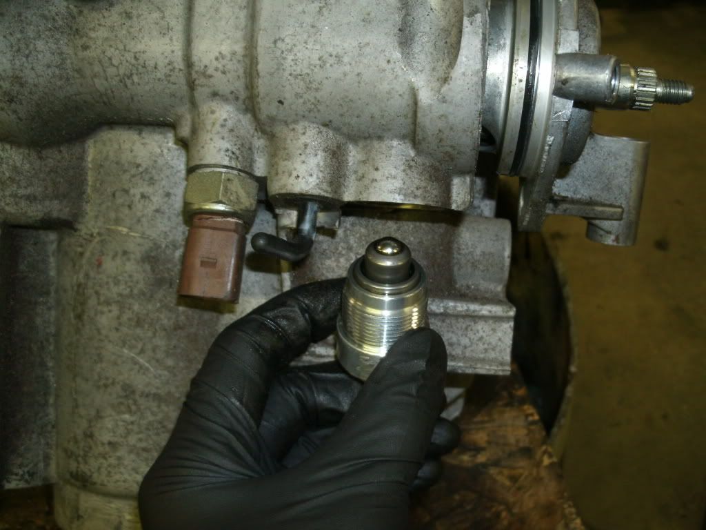

Originally Posted by Whitbread View Post
On mine, I also had to remove this guy to get the tower out
"This guy" caught me by surprise... I did not test it with a magnet and it IS NOT MADE OF STEEL! All of the case bolts in my 02M were steel... I have a GUC code gearbox from a Seat Ibiza.
SO, my first attempt to remove it with a 12-point 16mm socket turned into an accelerated learning experience. The bolt was rounded almost instantly. Crap.
Fight fire with fire, I say. I took a 15mm 12-point and a hammer so that I could perform a broaching operation on the round aluminum bolt head.
It's not pretty, but at least I can keep on muddling through the job.
