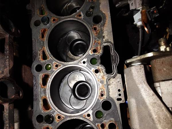

I removed the valve cover and 1 valve was destroyed. The others looked fine. Timing belt was tight appeared not to have jumped... I need to remove the head. I couldn't find a valve12MM TRIPLE SQUARE CYLINDER HEAD BOLT TOOL locally - autozone, etc. I ordered one online. Should be here Monday.

Heads and Piston-
Still can't determine why there was interference. Sending heads to Frank.
