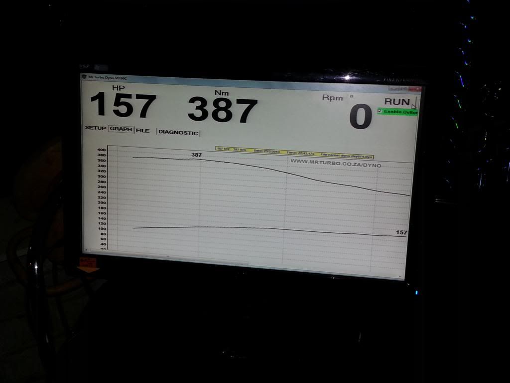

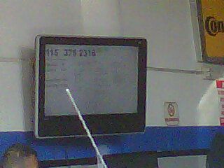

added some tuning ,
115kw 378nm @ Kwikfit Chatsworth Durban,
157hp 387nm @ Richards Bay
The car managed a 15.8 standard, 15.5 with a cheap remap and i brought it down to 15.2 with a self tune. with just a de-cat and mufflectomy.
