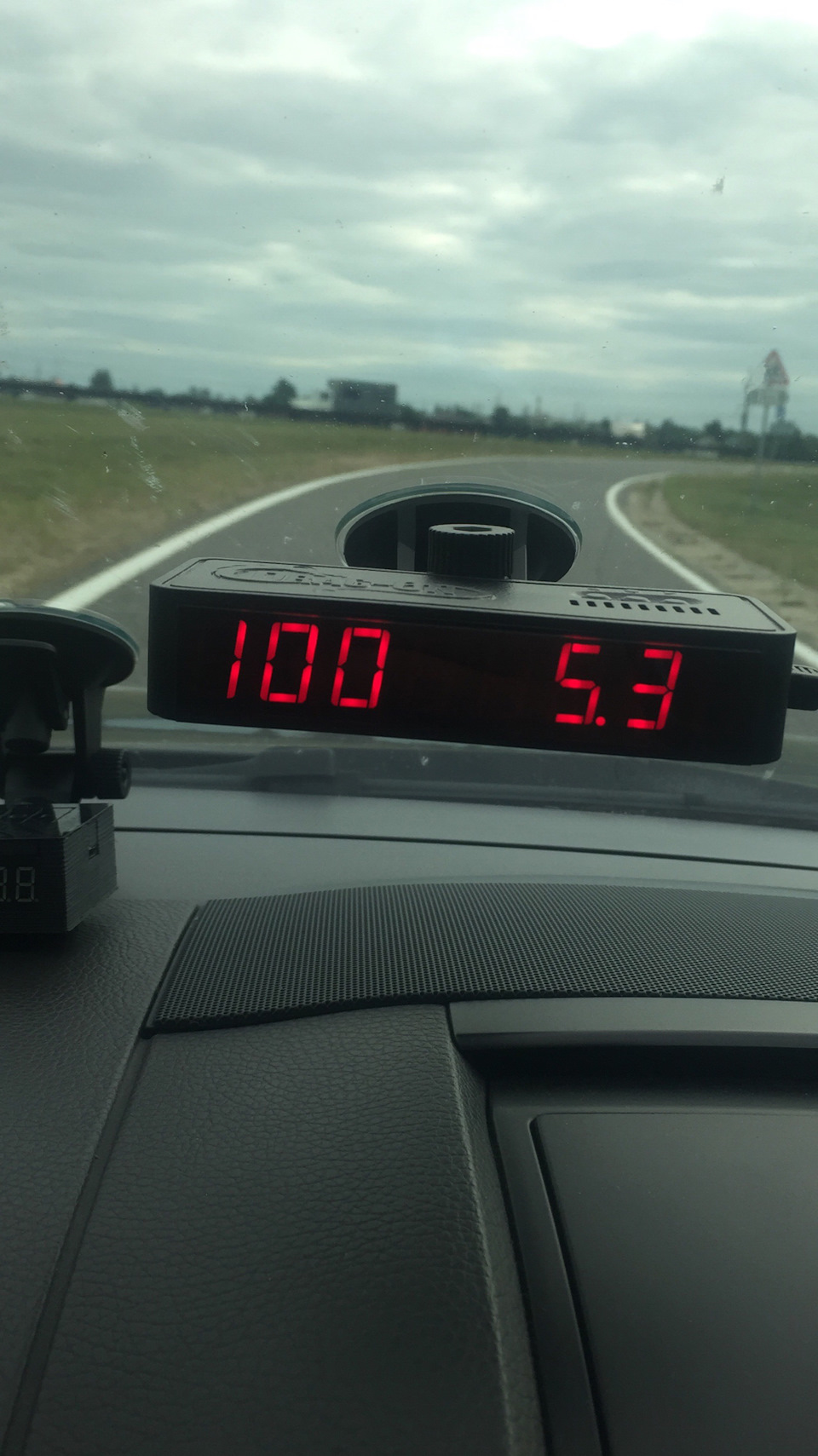

I'm from Belarus! Built Touareg Stage 3.Three years ago.
On factory he had 224 hp. 3.0 Tdi BKS.

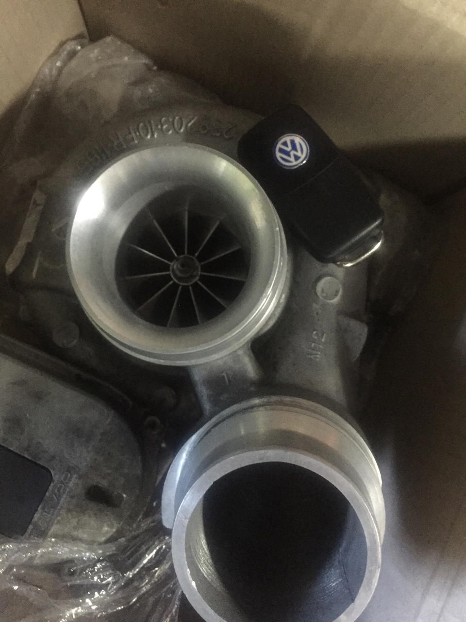

A gtb2369vk turbine was installed.
Intercooler APEXI.
Fuel pump CP3.
Water/methanol injection.

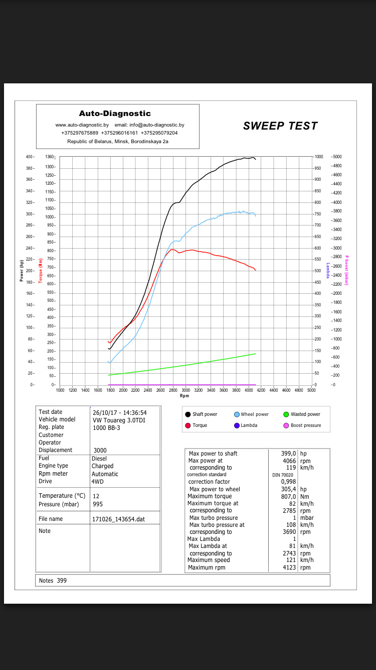

It turned out to remove 399hp and 800 nm.
0-100: Best 5.3s (stably 5.5s)
402m: Best 13.43s (stably 13.6s)

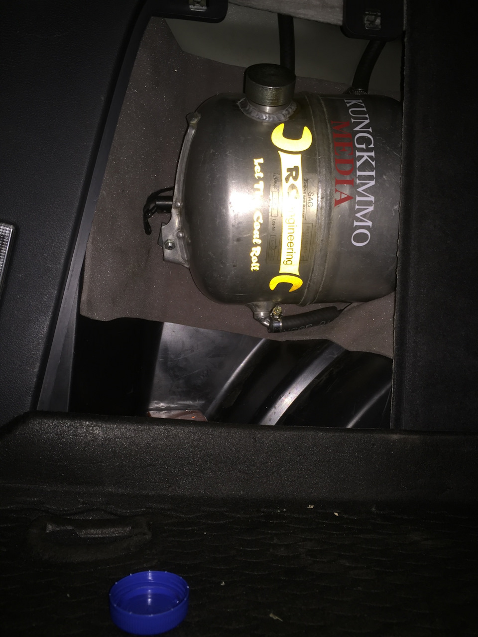

For the water methanol system, a custom tank was made.

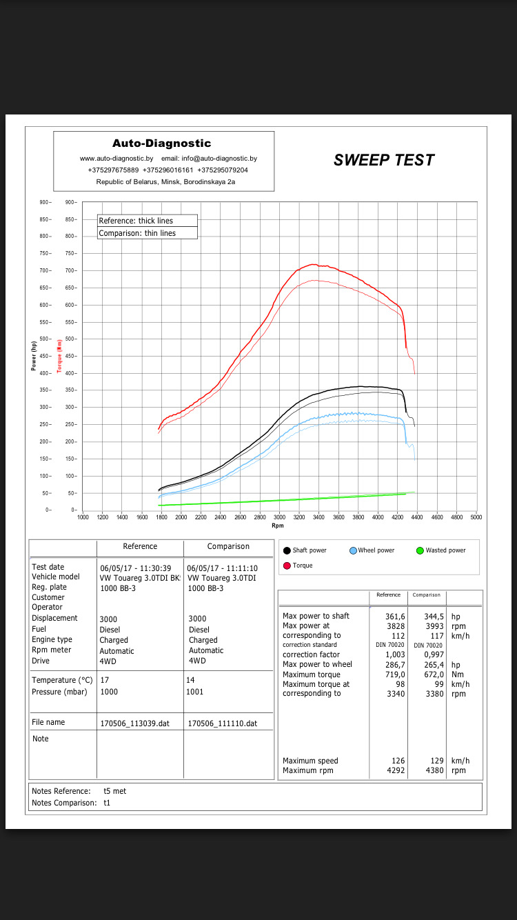

I used two kinds of superchargers gtb2265vk and gtb2369vk.You can see the difference on the charts from the stands. 23 wheel, allowed more fuel to be used at a lower EGT.
Here you can see on the chart the power of gtb2265vk. With water methanol and Without water methanol. This is the maximum that was possible with this wheel. A graph with 23 wheel above in the subject.
