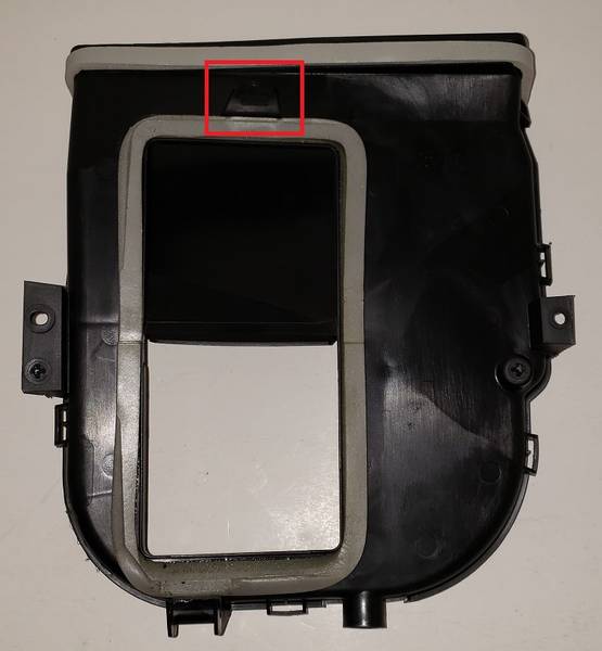

Here is a picture of the back side of the rear plenum housing. I have to think the tab that I have highlighted in the red box in the image below was what was keeping this part from coming out easily. Note, that the foam gasket on the back was in good condition, but the upper gray gasket shown in the photo, I installed after removing the rotted foam one that was there originally. I also installed new foam gasket material on the front plenum cover as well.
There are plenty of good discussions on foam vs aluminum duct tape, so I will not go into that, but I did want to highlight one part of the rear damper door that I nearly missed. See the boxed area in the photo below.
Here is my completed dampers after cleaning them off and installing the aluminum duct tape. Make sure you reach your finger through the holes and remove as much or the foam from the back side as you can. I was unable to apply the tape on the back side but getting foam off is important step.

Here are a couple pictures of both plenum half's from before I removed the old foam and installed the new foam.
I am taking my time, and pretty much finished up this morning, but I would estimate it has taken 5-6 hours.
