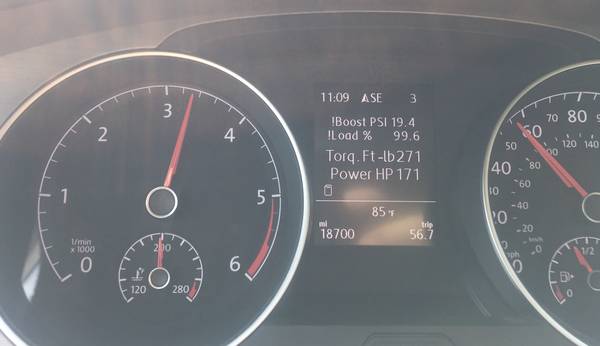

Been playing with mine some, it's useful.
Still some things I'm not sure about, or need fixing. Coolant temp shows negative, what does ! mean before a parameter, MPG and degrees F options... Much of this could be user error or lack of understanding how it all works, I'm not sure yet.
With the update version I have EGT isn't yet available, but I'm told it will be in a week or few. They are apparently still working out the finer details for this application.
The text does jump around some, which if you're looking at it for a while isn't ideal, but if you're actually driving and just glance at it quickly, otherwise keeping your eyes on the road it's not noticeable. It'd be nice if that were fixed, but then again it's not a big deal.

HP says 171 and TQ says 271. Do you have a tune? EGT and DPF temps are key to monitoring regens. You'd think that they would have figured this out by now...

I don’t have a tune.
The boost is available with or without subtracting atmosphere, that picture is with the correction.

I guess the HP and TQ figures are to make you feel good?

I guess so? I don’t remember what the car/engine is supposed to make, but I wasn’t thinking that high.
