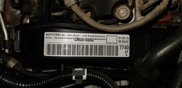

That would be great, but I am a little confused when I look at my engine sticker

That's a zero, not an "O". Your car has the CRUA engine.
OK thanks will give it a try
