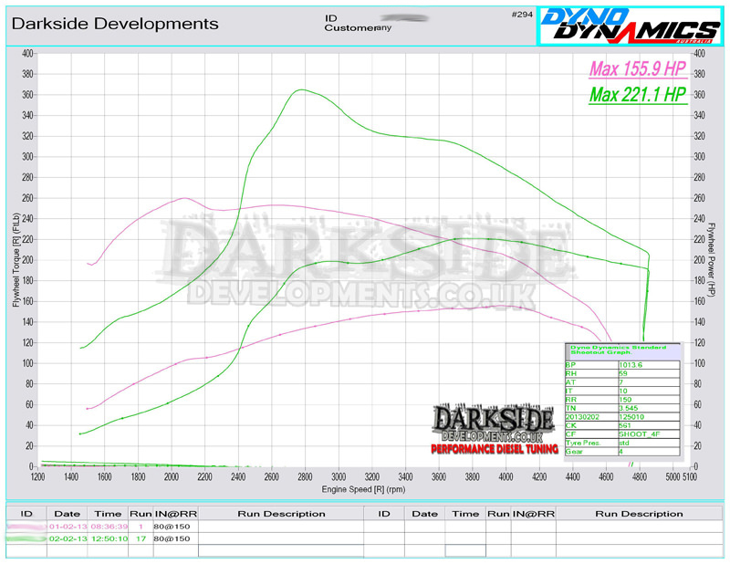

Took it to a place I'm sure many of you are familiar with, Darkside Developments, for a DPF delete and Stage 2 mapping.
And here are the results.
EGT's limited to 850 degree C verified with Polar MFD add on.
195bhp and 340lb ft.
Stock intercooler at this time.
Can't see how people can get a genuine 220bhp from these engines.
